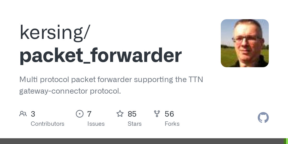

I used this recently, worked a treat:
Are you running Balena? In that case you will need updated scripts which are not there yet (afaik) because the current script pulls the gateway config from V2.
For plain Linux gateways updating the server address for ‘semtech’ transport is sufficient. For ‘ttn’ transport you need to update ‘serv_gw_id’ and ‘serv_gw_key’ as well.

If you read this topic you’ll see I posted a link to the software I used just three entries above yours.
Two entries above that is another suggestion for a solution.
Thanks for the recommendation @kersing (it’s already V3 by default)
