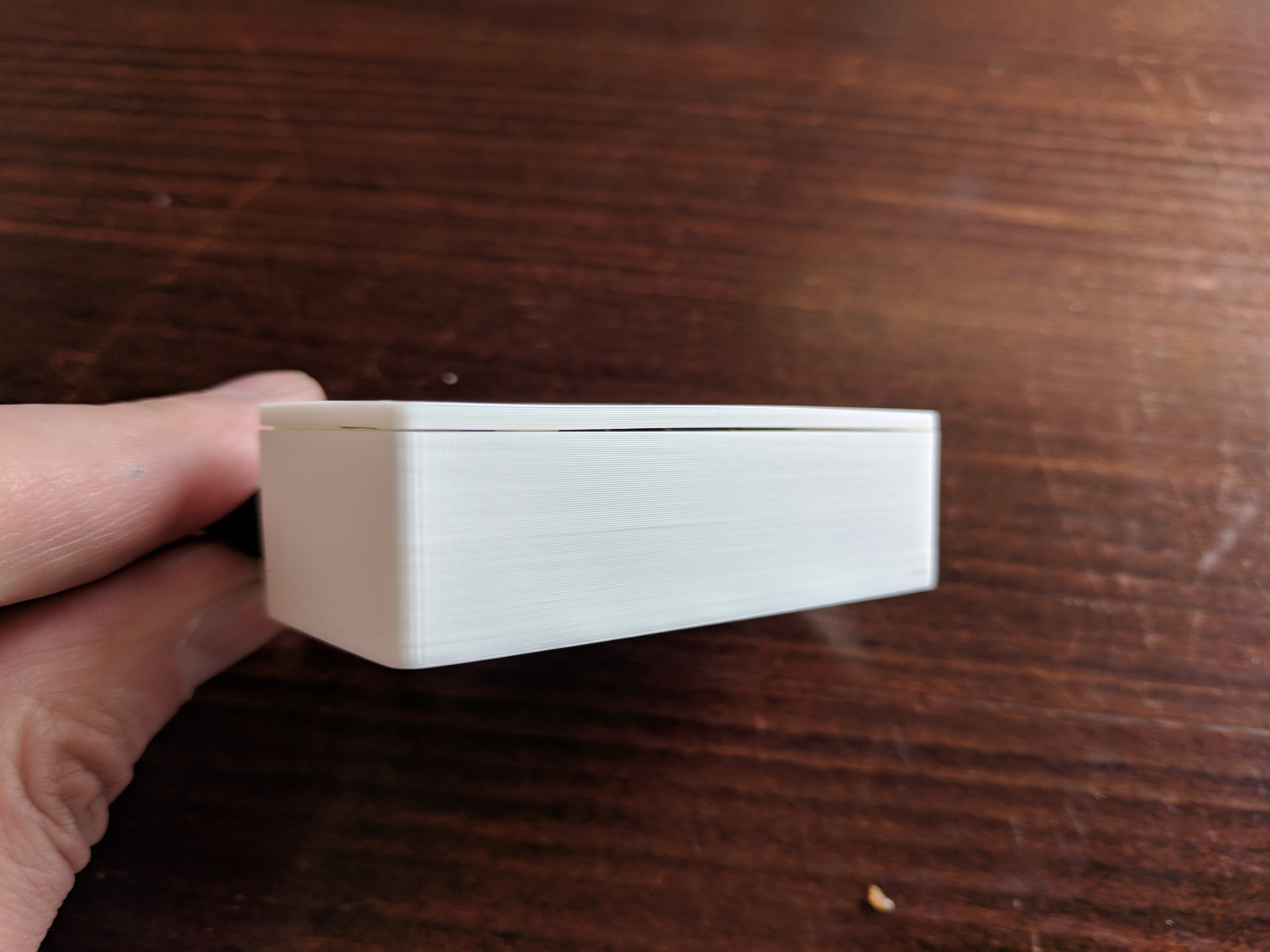

@pixelchain I think we need to increase this one
IMG_4170
IMG_4171
(Verkehrsrot) #381

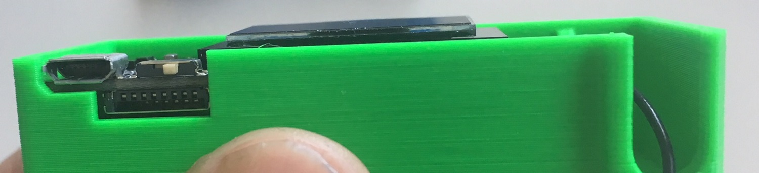

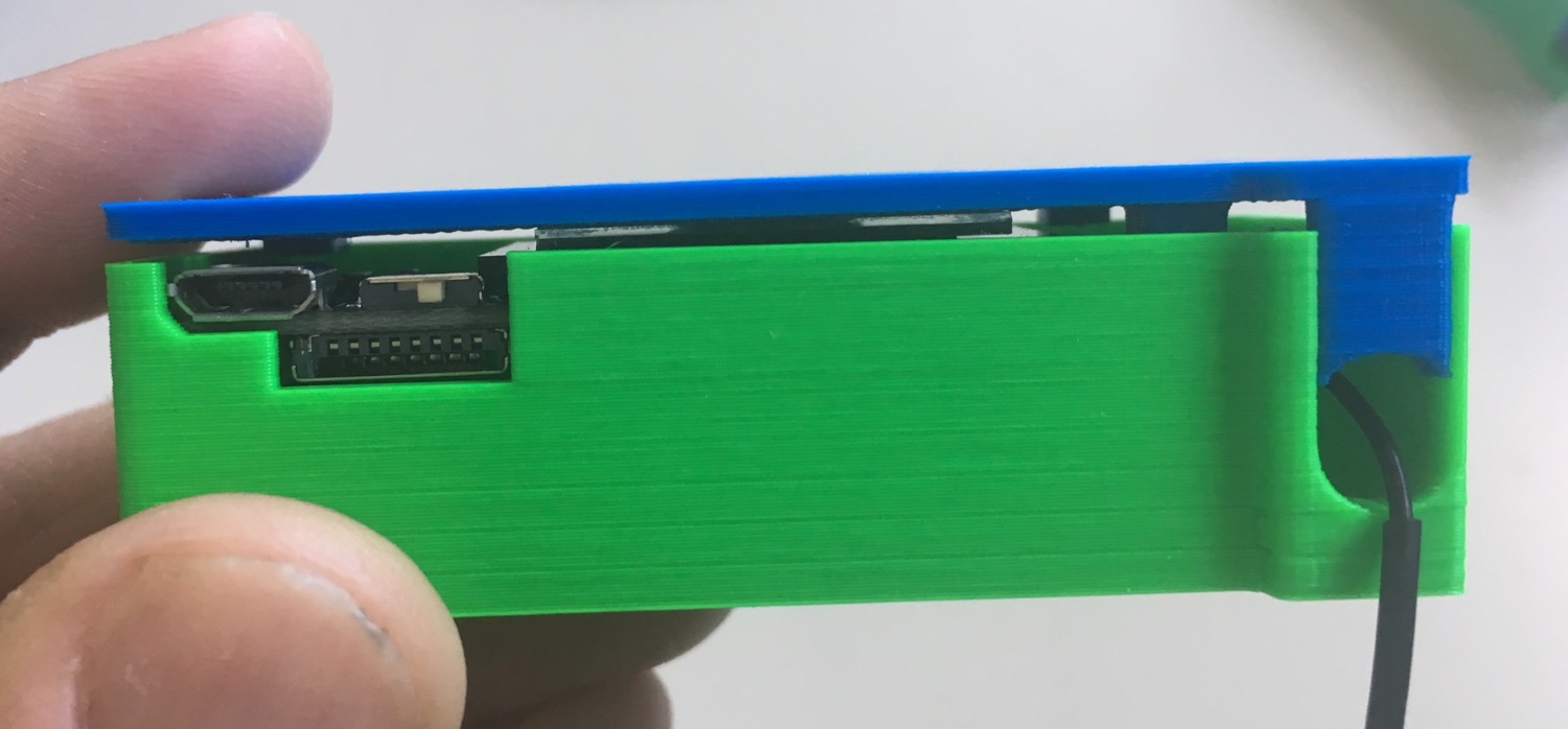

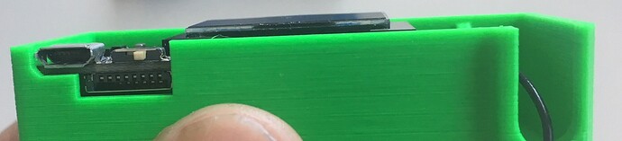

could be tolerance of 3d print, my case fits in this point. But does not with the display Passepartout.IMG_20180405_140555IMG_20180405_140548
(Pixelchain) #382
@Verkehrsrot: I was printing mine with 0.2 resolution. Not sure if print service did the same. You can use a file/cutter to adjust a little.
@Charles I think that was an old bogus cached/temporary model. When I get some time I will double check the current upload. After printing I will make some detail photos.

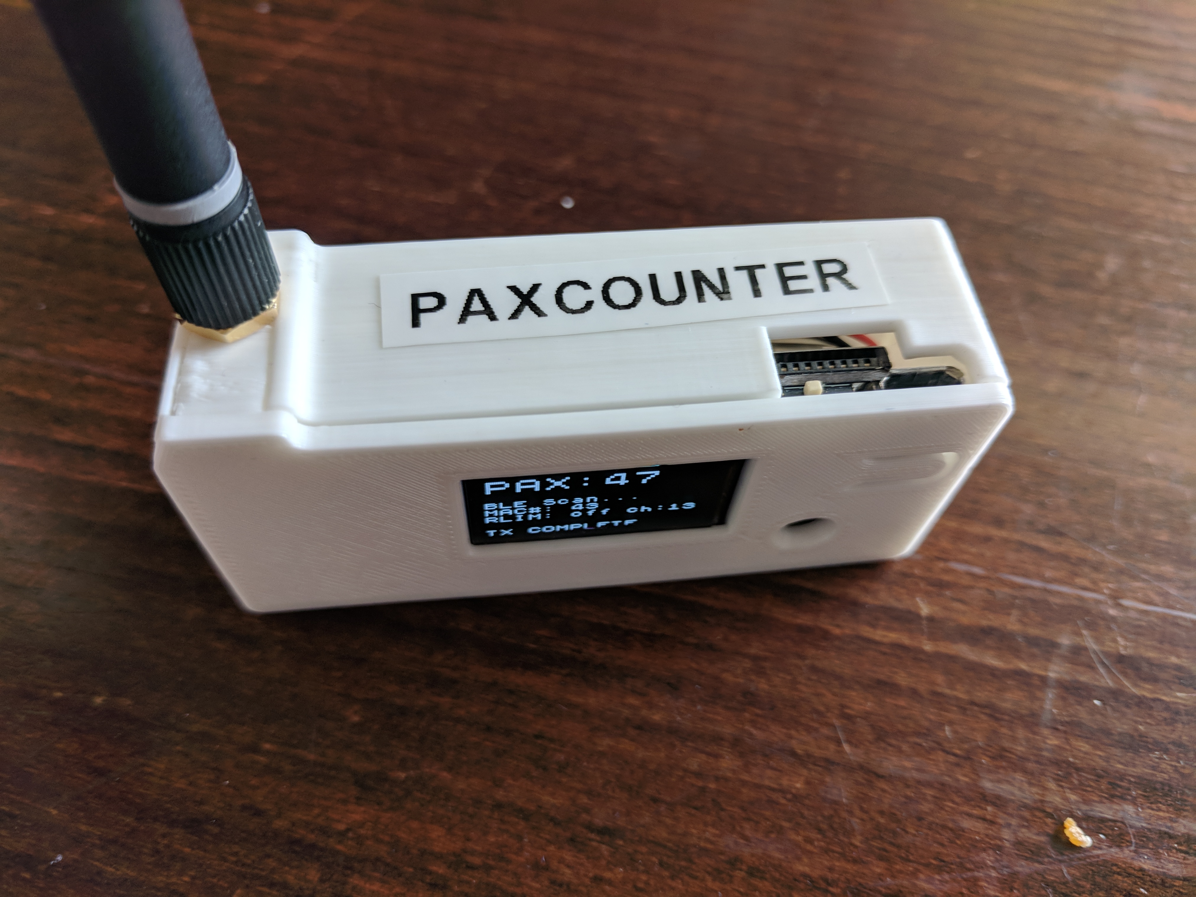

#386
Guys made me some and I’m erally happy with the result, looks fine :slight_smile:
