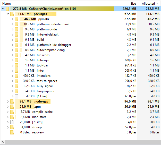

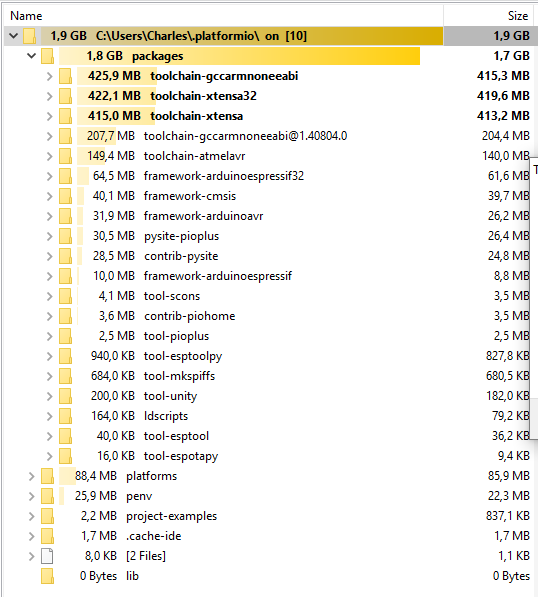

I am using a PC with only 128GB of SSD memory, and it is almost full, so I am not sure if I have space for PlatformIO if it taks several GB. Any idea of its size?
For atom
For platformio, I’ve got 4 targets, STM32, ESP8266 and ESP32, (each approx 500mb) and the last is for arduino avr (140mb)
The heavy ones are for the toolchain
So in your case with atom and ESP32 should be total less than 1GB
