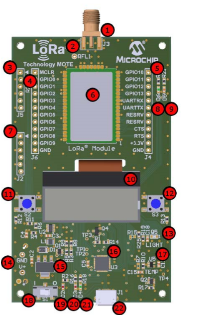

In which i upload the picture of RN2483 lora mote and also inside connection of lora module.
Is possible to run the program of PIC18LF46K22 in lora module when the mote enter into bootloader mode?. Please give any solution for my problem. if it is possible through bootloader mode, how can i enter the mote as bootloader mode?
