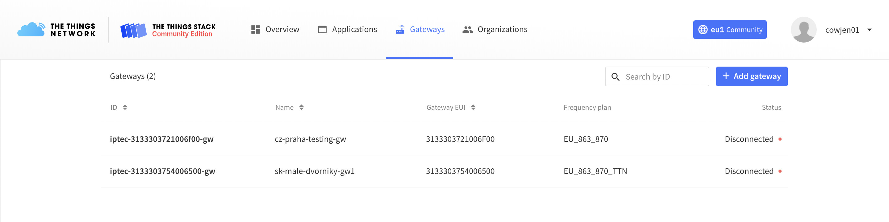

Hello, I had to change the gateway ID of my two existing gateways, so I deleted them and then I recreated them with the same EUI. After that, both gateways are with in a Disconnected status for almost 48 hours.
Screenshot 2021-04-27 at 16.11.54
I check the gateway logs and traffic logs, all seems to be just fine. Before the recreation, both gateways worked without any troubles. I’ve also tried to reboot the gateway, but with no results.

But when I try to check gateway’s stats calling ttn-lw-cli g get-connection-stats iptec-3133303754006500-gw I get:
error:pkg/gatewayserver:not_connected (gateway `iptec-3133303721006f00-gw@ttn` not connected)
    gateway_uid=iptec-3133303721006f00-gw@ttn
    correlation_id=c581540c3ac24637b100f53a14793192
--- error:pkg/redis:not_found (entity not found)
Would anyone be so kind and help me to resolve this issue?
