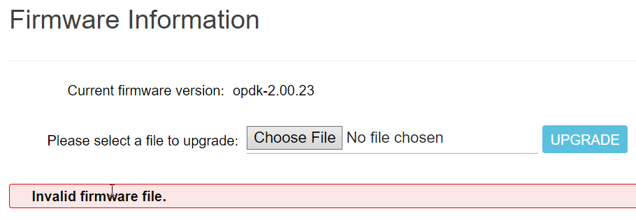

Decided to upgrade the firmware before anything else. Used the download link from the official TTOG docs. - Resulting in the LOWER version 1.01.09.
Searched the forums. Found a link for 2.00.23 (Basic Station) and installed it. Not sure about what version to use, but anyway can’t go back to an older (major) version now:

On the screenshot of the official docs I found a filename with a version 3.09.99 (link, which is not working on the TTOG):
Is it really that hard to get an up-to-date firmware for this gateway? Is there a list of compatible firmware versions with download links?

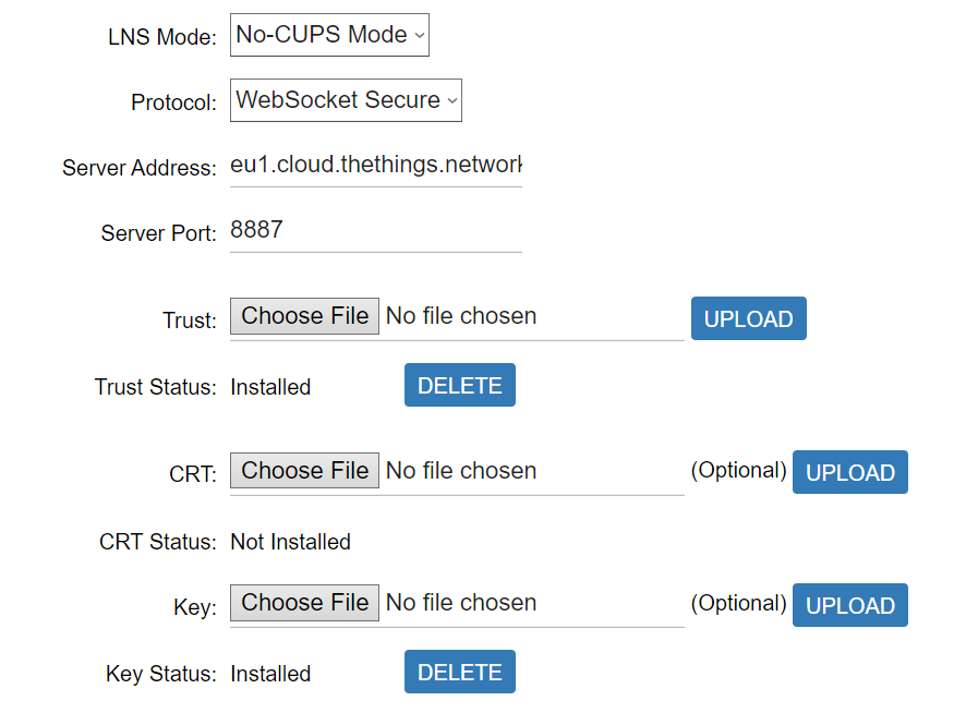

Sat down with the above mentioned TTOG with Basic Station 2.00.23.
Re-created the lns.key for Key and used the minimal ca.pem for Trust:

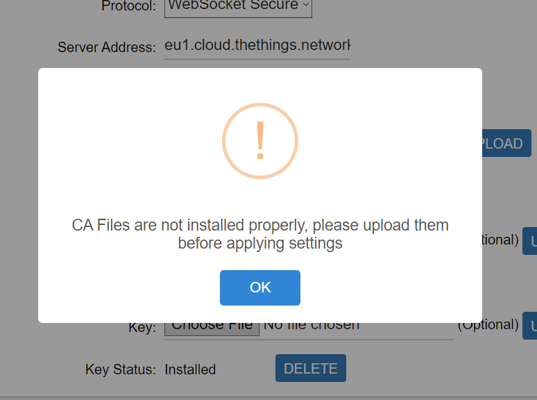

Interestingly, if the file doesn’t have the right name, you get an error “CA Files are not installed properly, please upload them before applying settings” when you hit “Apply”:
This happend to me, when I uploaded one of the previously downloaded files, that are automatically renamed by Windows into “cacert (3).pem”.
So that’s just an error case that isn’t handled well by the ODU web interface. The error message says the file is not uploaded, but it actually is, just with the wrong name.
