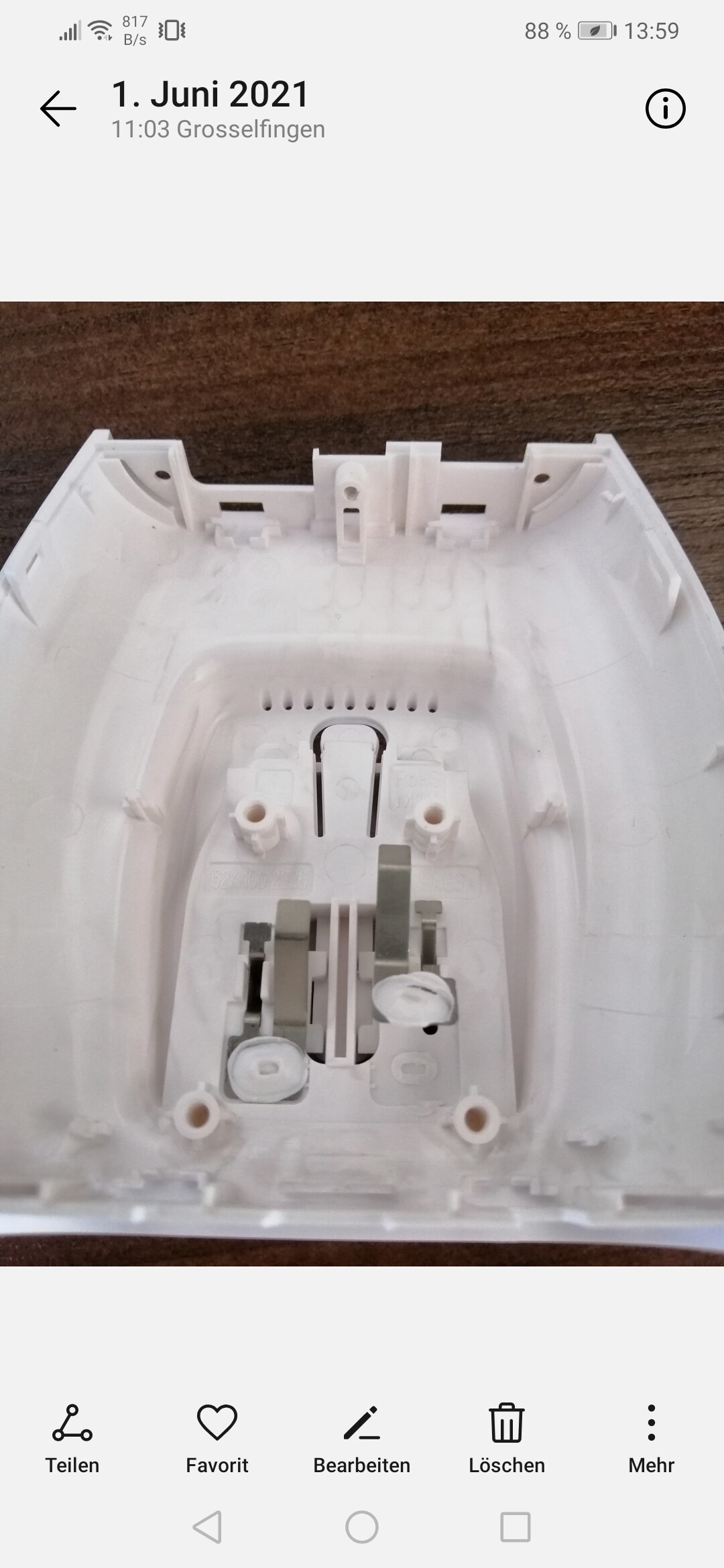

Take a look at the pic, from memory the process is pop off the top and bottom covers which you can see are clipped into place with small lugs. Underneath you will then find a couple of small screws (I think one at one end two at the other?) - take them out and that allows the case to be split…again held by plastic clips/lugs.

I found the error an broken platic holder. I fixed it and when worked again.

I had exactly the same problem! The mains connectors appear to be held in place by melting the plastic posts onto which they are fitted and pushing the melted plastic onto the metal connector forming a very crude type of rivet. My TTIG had been sitting in an outlet for about a year before the plastic ‘lump’ disintegrated and the power connector became loose. Fortunately it failed in a way that disconnected the power, it would have been worse if the connection became intermittent, causing arcing and a fire.

I’d note that my TTIGs certainly get warm to the touch - warm not hot - the PSU & its PCB are certified, the plastic that holds the connectors in place is covered in quality marks and being ABS would need +225ºC to melt.
The picture above looks like the ‘button’ sheared off. So you will probably need to take some pictures to demonstrate the melting idea.
This sort of multi-use adapter assembly is widely used - like in the original Raspberry Pi PSU’s. If I pushed the protruding metal spring really hard whilst putting an adapter on it I could see how I may be able to snap the button off.
