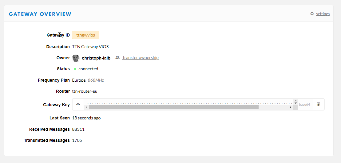

hi there
after havin flashed the GW, it seemed to work properly, but since one month, the mysery started again.
The GW led’s are up, and the 5 is flashing quickly when packets arrive, but nothin on the console. It is as the GW is numb…
many thanks for any qualifyed tips !
