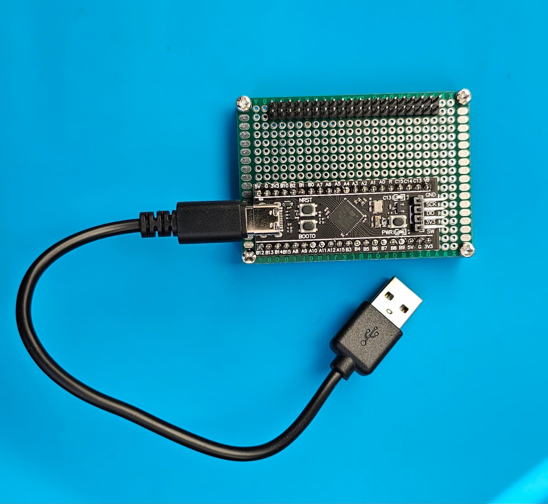

There are many cheap lora concentrators on the market now, due to Helium denylist. But the Raspberry Pi is still not cheap, and almost all the concentrators are using SPI interface, so here using a STM32 blackpill as the interface convertor, let the concentrator talking with the PC.
All you need is a Linux PC to run package forwarder or basicstation, a stm32 blackpill flashed with following firmware:

Here is the pinning:
PA1: sx1302 power_en
PA2: sx1302 reset
PA3: sx1262 busy
PA4: sx1302 CS
PA5: SCK
PA6: MISO
PA7: MOSI
PB0: sx1262 CS
PA8: sx1262 reset
PB6: SCL
PB7: SDA

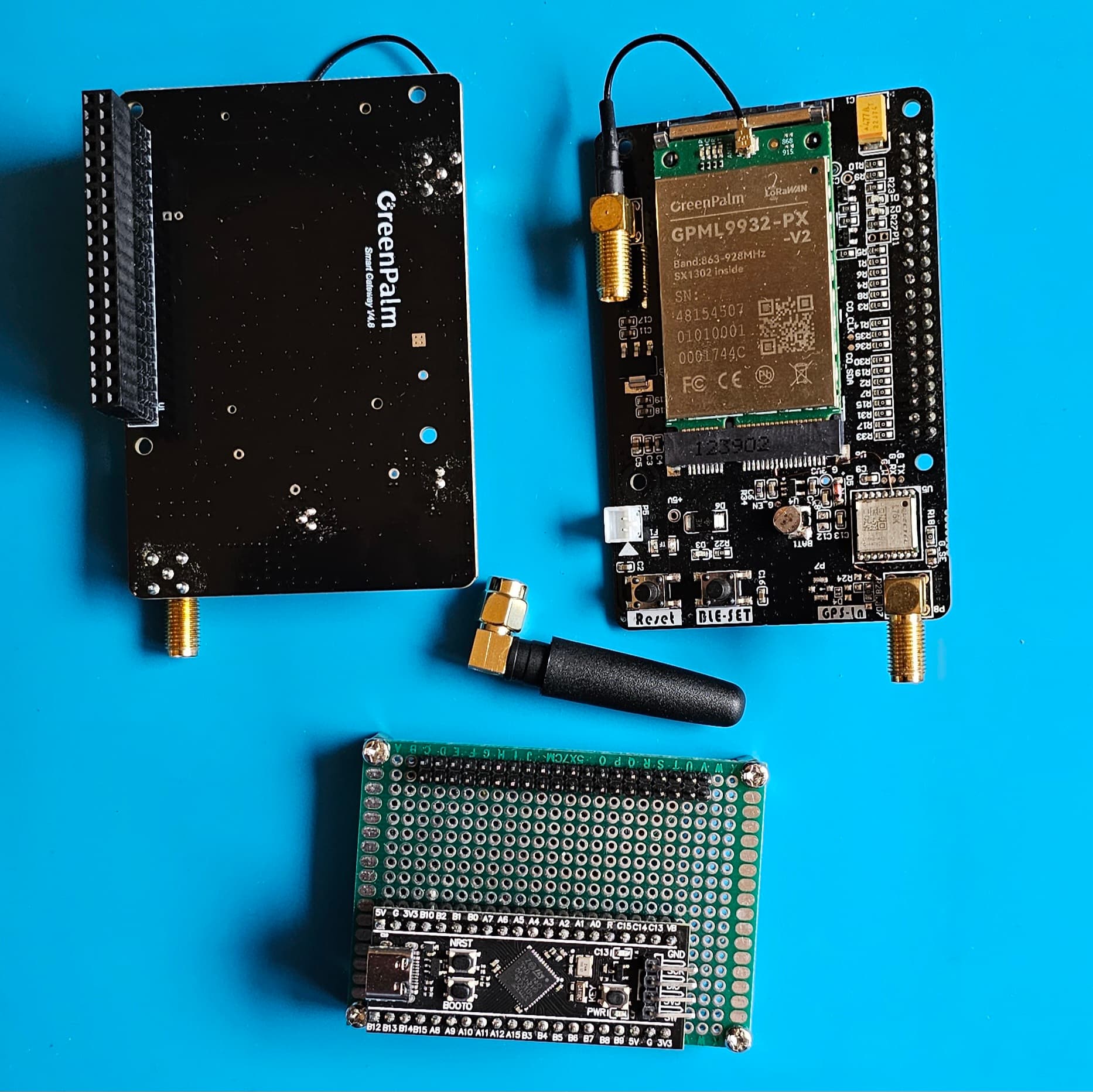

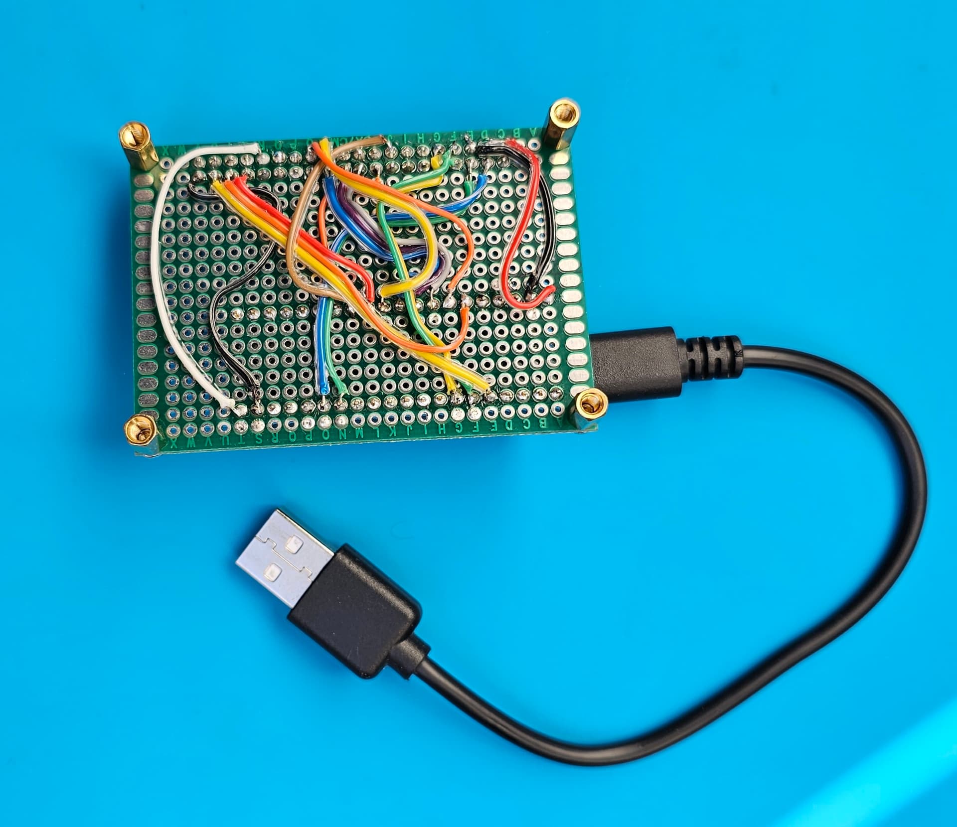

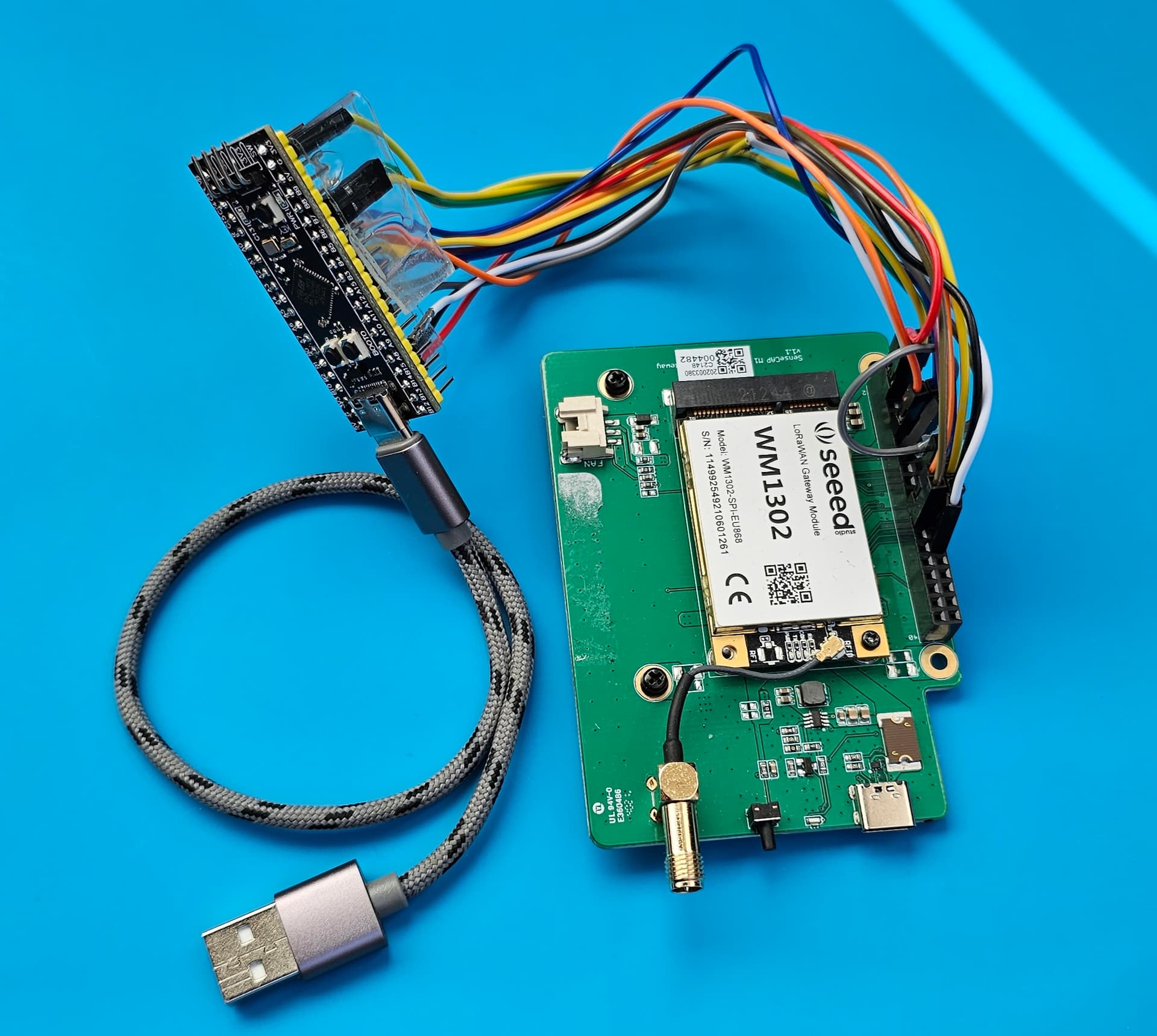

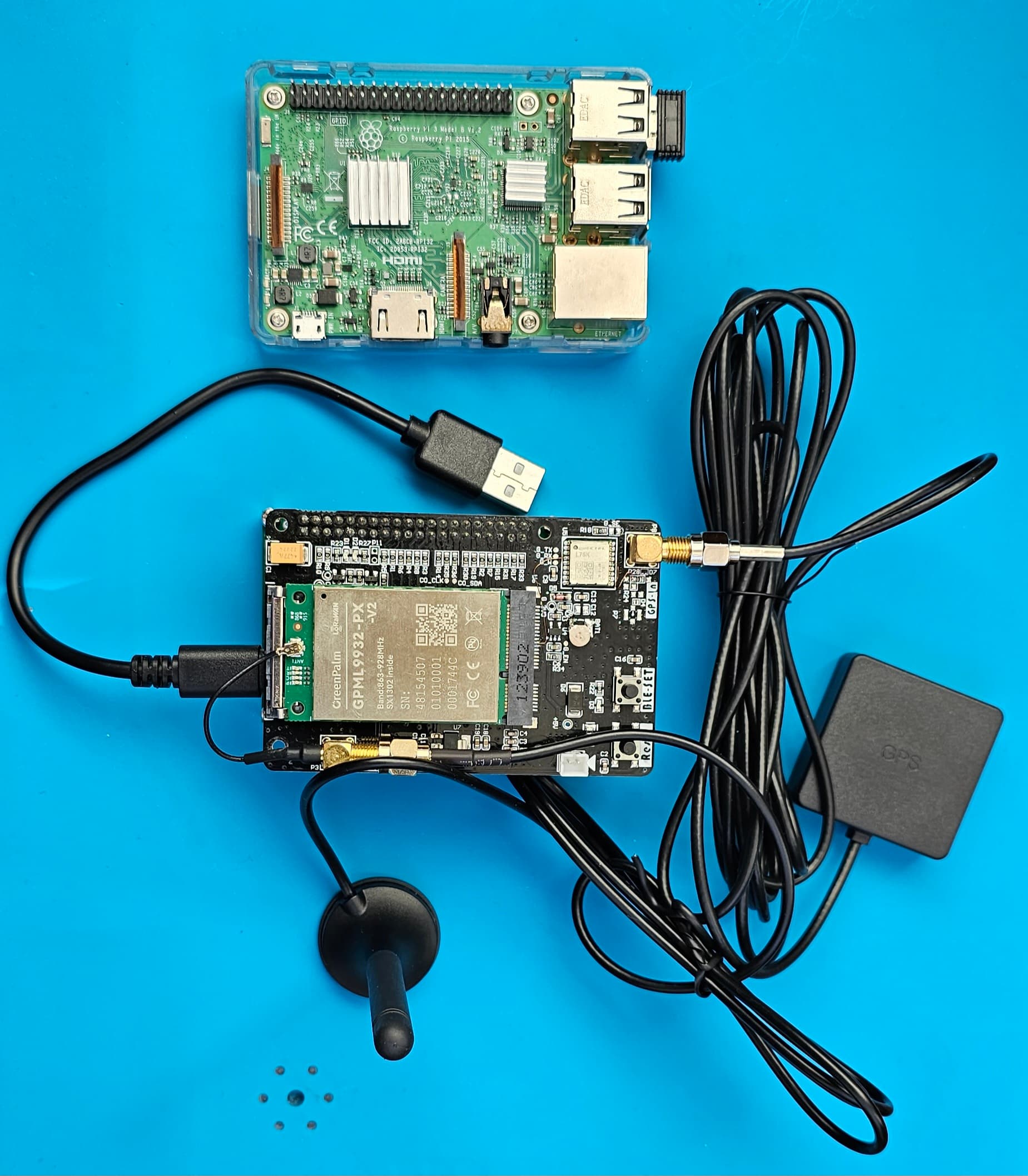

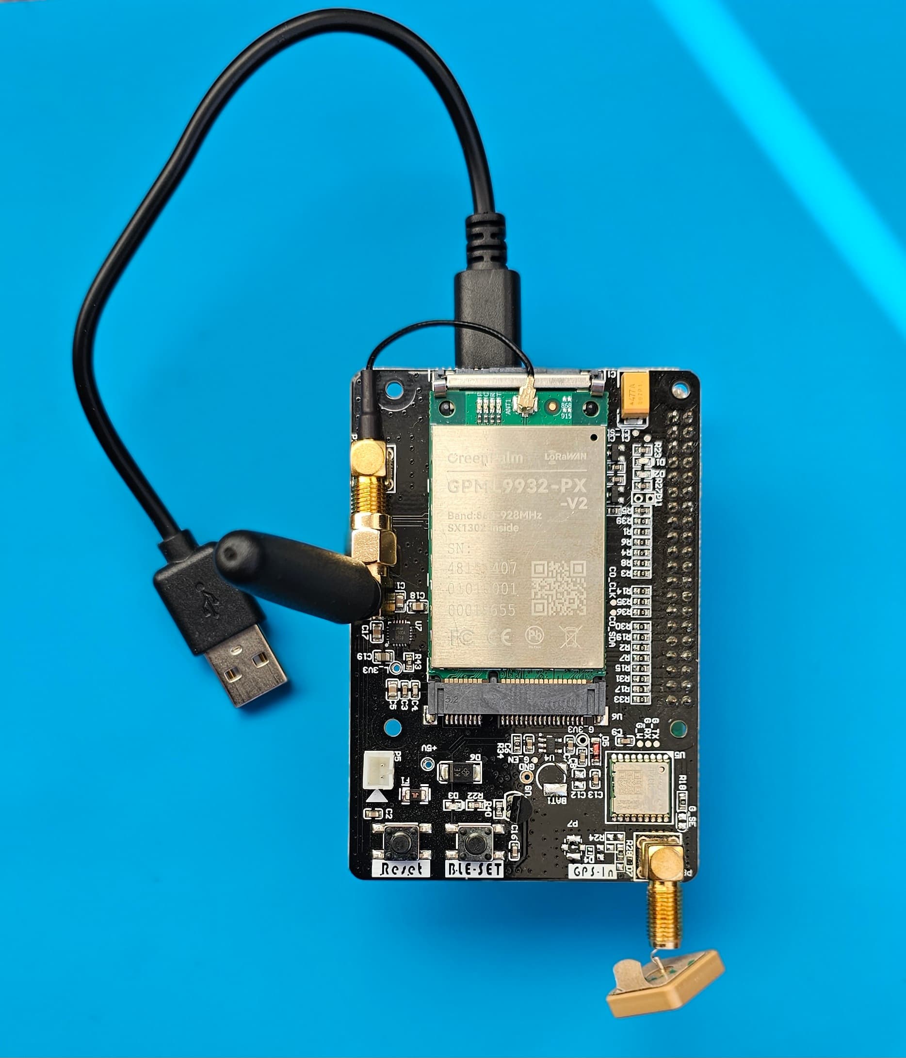

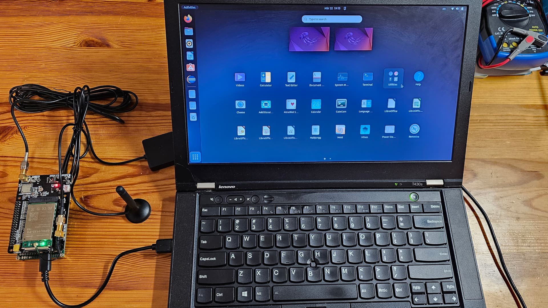

My first prototype was based on WM1302 concentrator from Senscap, with many colorful cables. the second prototype is based on sx1302 concentrator from the Pisces P100 outdoor gateway, which has an GPS module on the HAT:
After connect all the cables between blackpill and concentrator, connect the blackpill to an Linux PC, in my case I’m using Ubuntu22, it doesn’t need any additional driver, and the blackpill act as a Visual Com Port, with the name “ttyACM0”

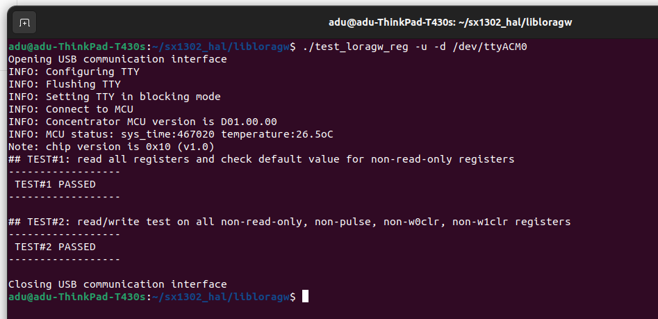

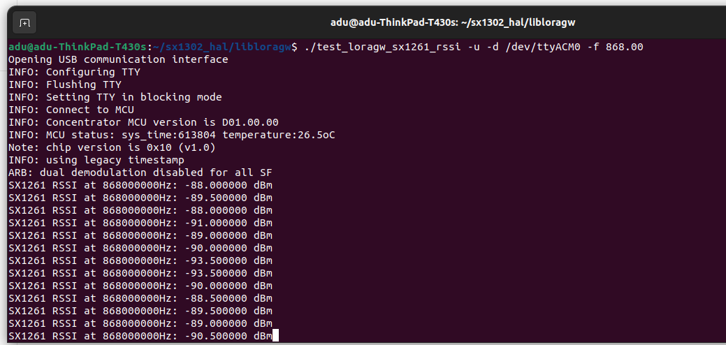

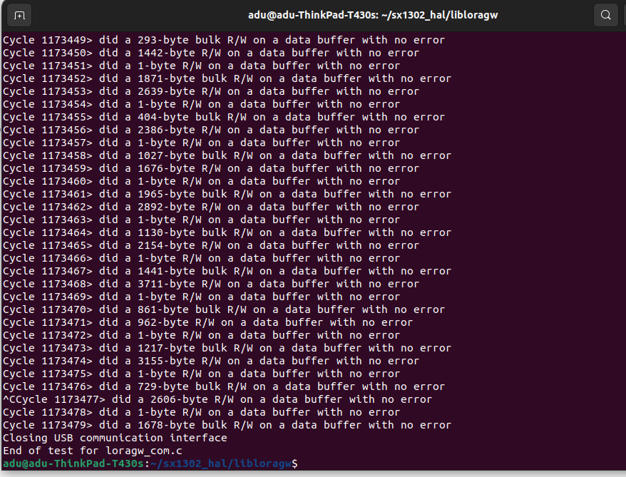

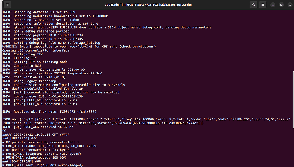

after that you can try to start the HW test with the tool provide by Semtech:
Reg test
Com test

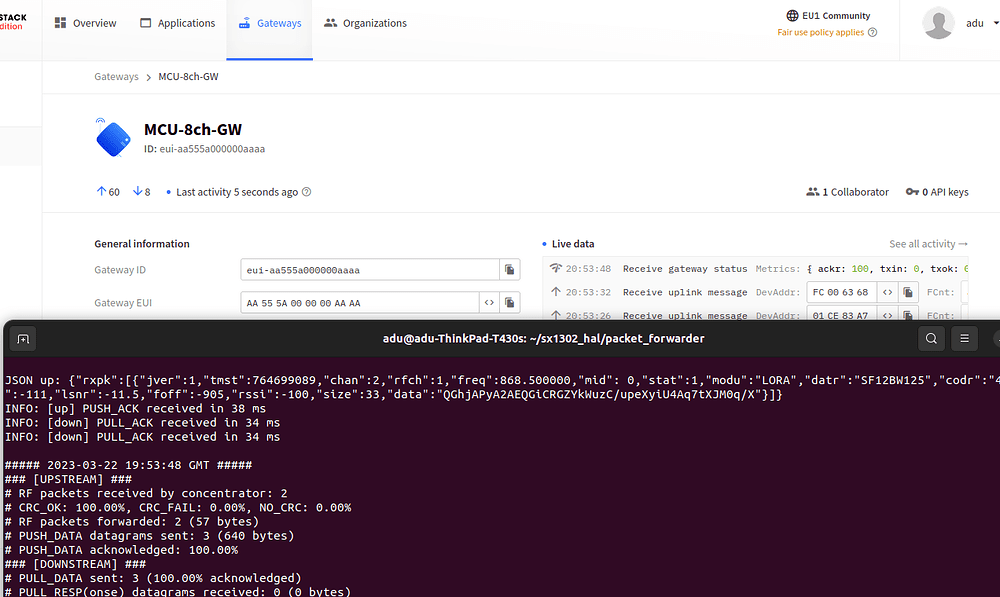

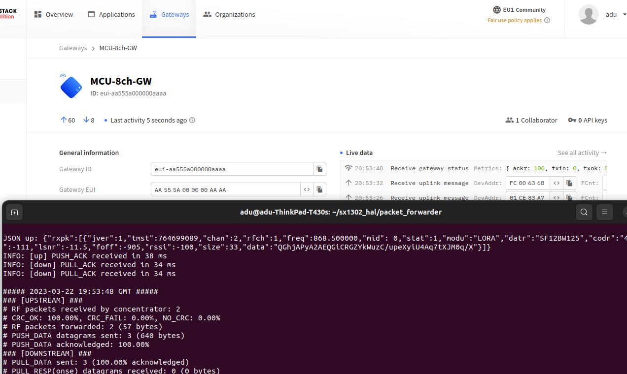

if everything is fine, you need to register this gateway in TTN, please refering the related instructions.

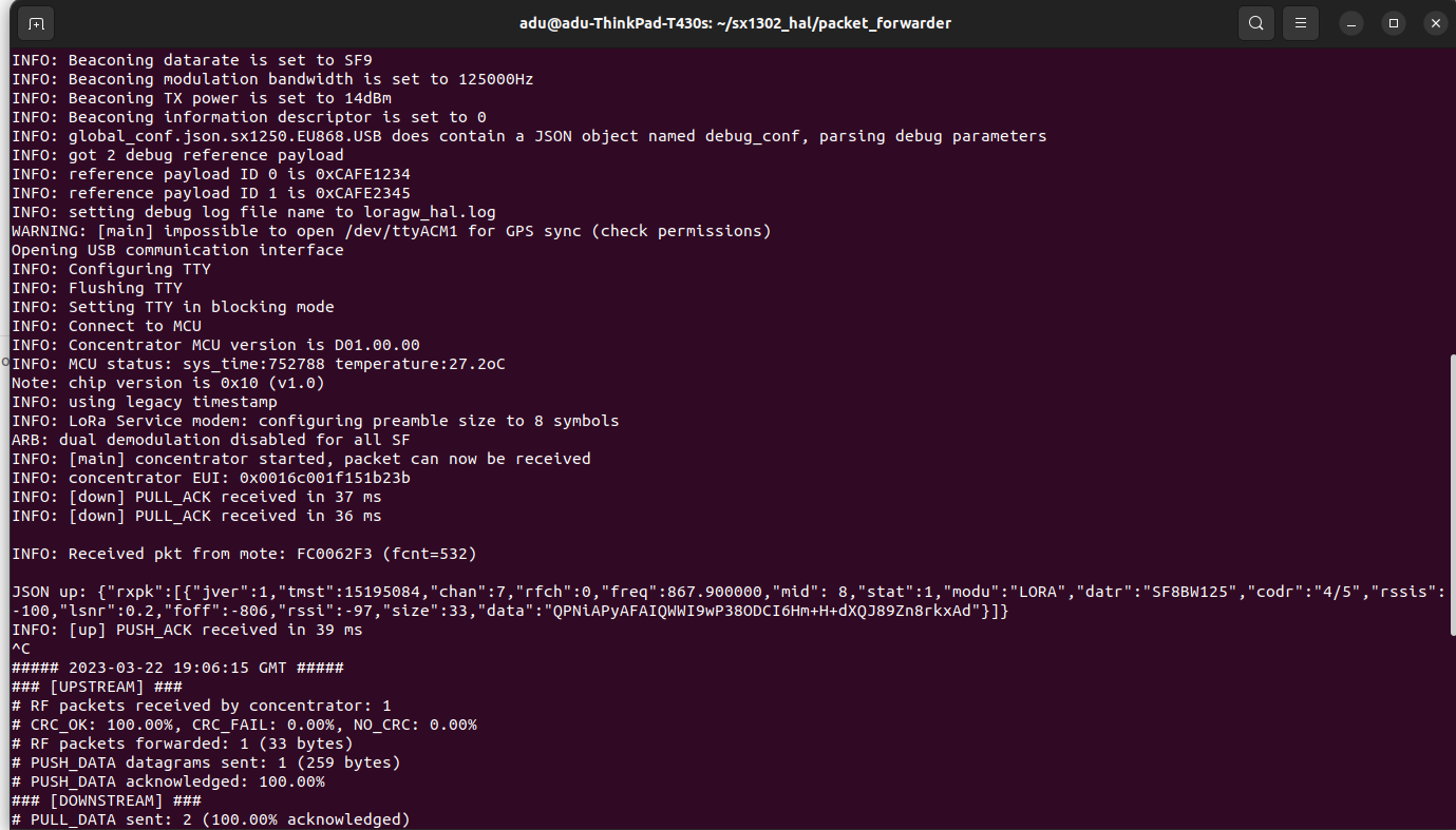

then start the packet forworder in the console:

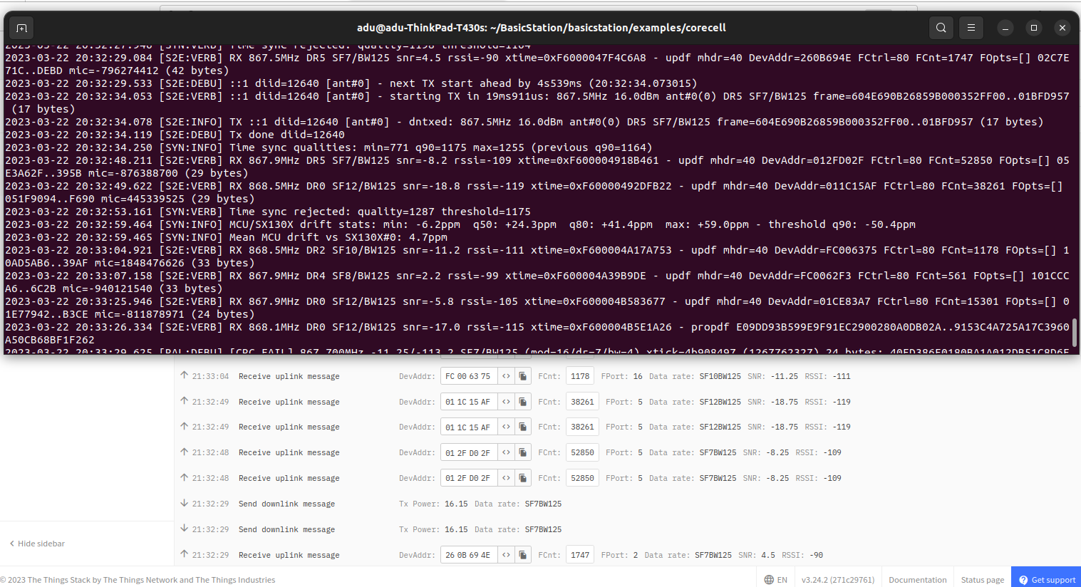

if you want to use basic station, just following the releated instructions, the harsware support this.

Hi Jac the top image looks to be from a SenseCAP (Miner) - usually mounted side-car style with a RPI4/3B+ in normal use vs usual HAT direct over placement (rotate through 180 deg so attention needed when connerting to Pi as ‘wrong’ way from normal! So ‘controller board’ in that case - is Pi and guess OP motivated to use something already in hand (Linux PC?) vs go hunt expensive rocking horse droppings right now! :wink: Have 3 off these on bench at the side of me waiting for time to hook up to various Pi’s I have in stock to then deploy on TTN as community node… :slight_smile: :+1:
