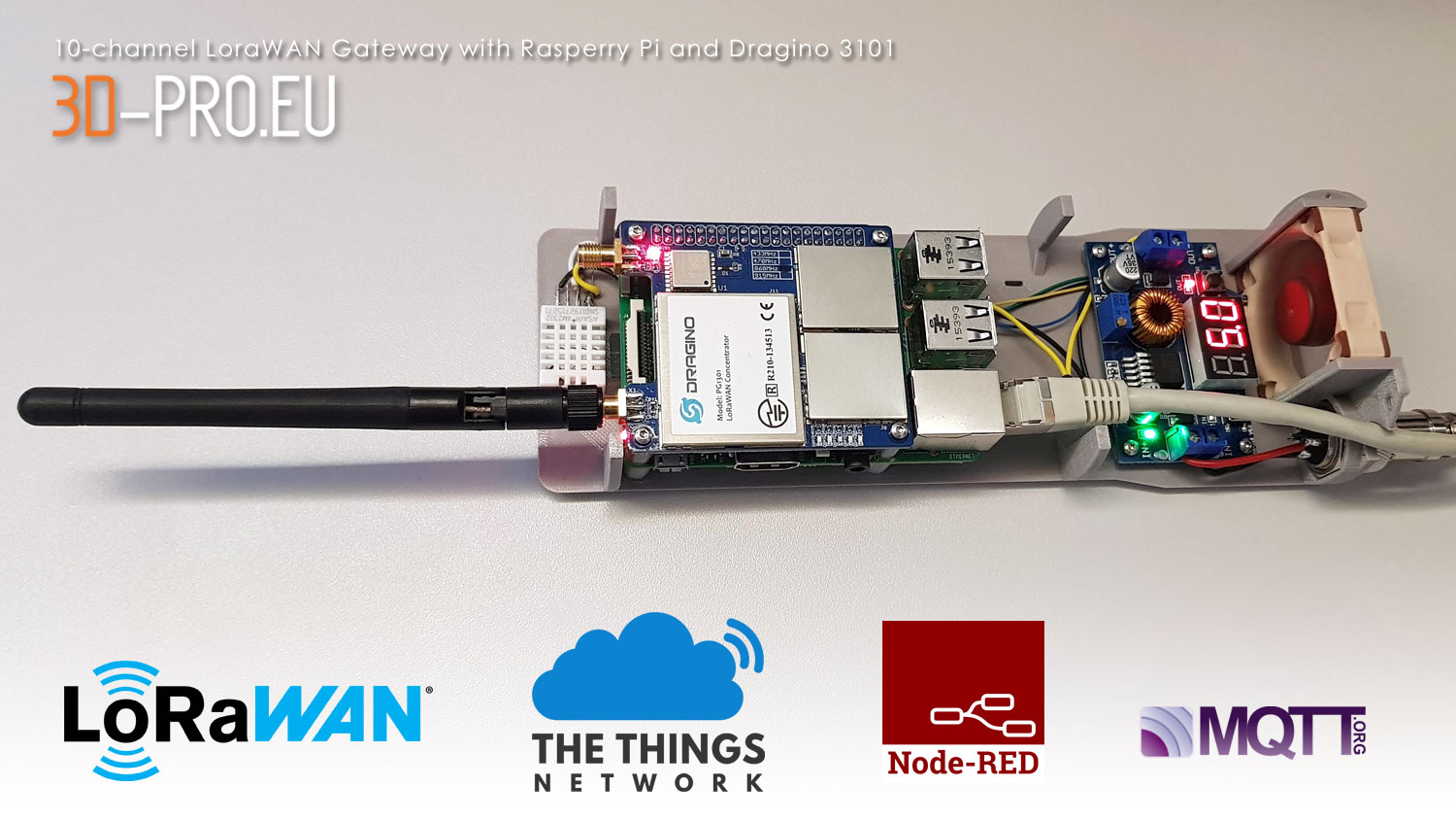

Hi, maybe you like my design with the RPi and Dragino PG1301
Yes, you can. I also works in a gateway with Raspberry Pi 3 B+ compatible due to the PoE characteristic. Look at the power consumption if this will be relevant in your project.
