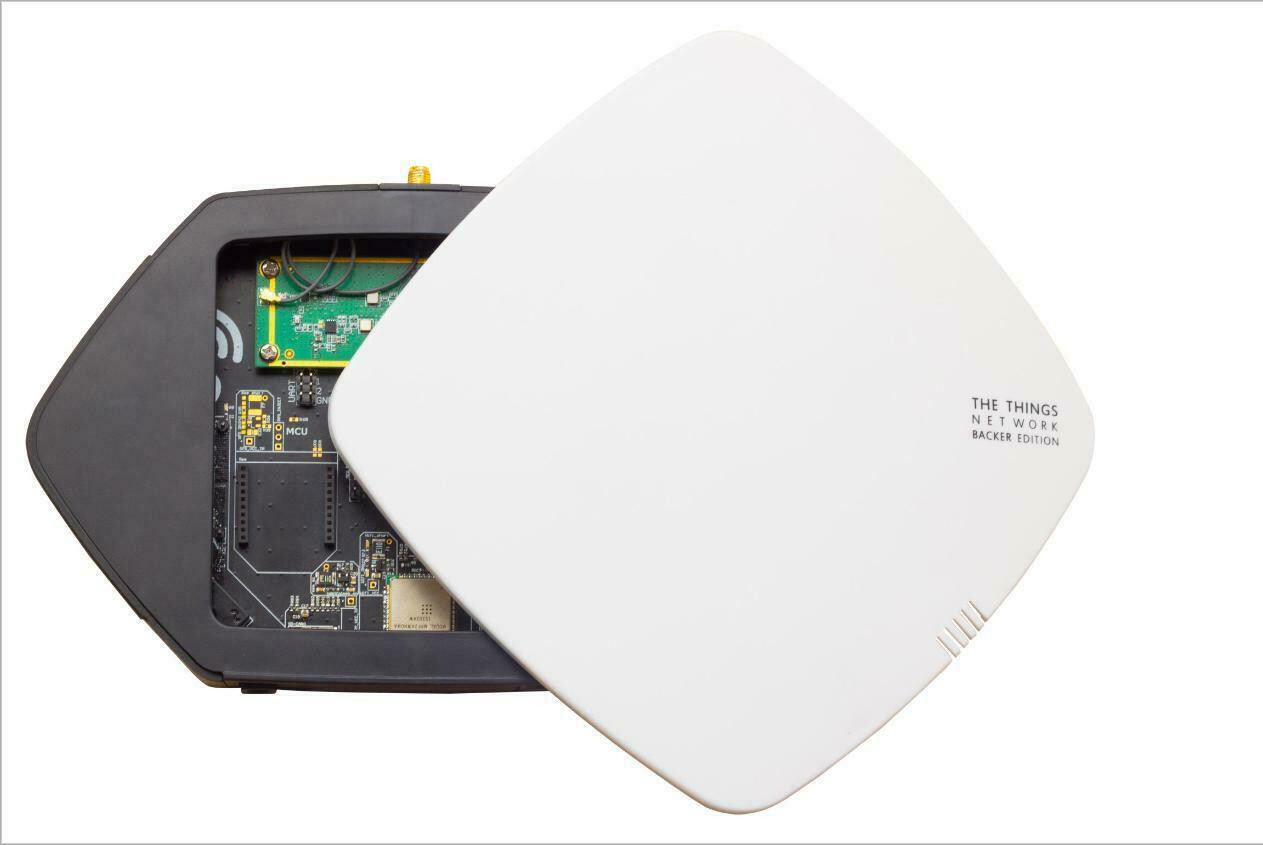

…depends on your perspective are you prising the grey lid off the black case/chassis or extracting the black rear case/chassis that houses the motherboard from the grey top panel/lid…Hummmm ! ![]()
the white lid is removed. I was talking about the black casing (took the snapshot from Newark website)

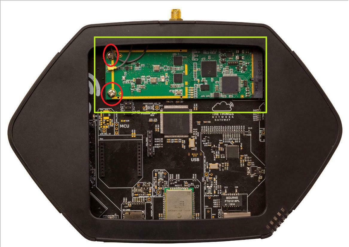

If you’ve taken the lid off you now have access to the card that you can reseat - referencing the pictures on other posts you may have found on the forum by now.
Undo the two screws and extract the card as requested…

Be very careful with the uFl connector - best not to remove it - they are only rated for about 20 uses. There is enough cable for you to unplug & re-plug the card without disconnecting it.
