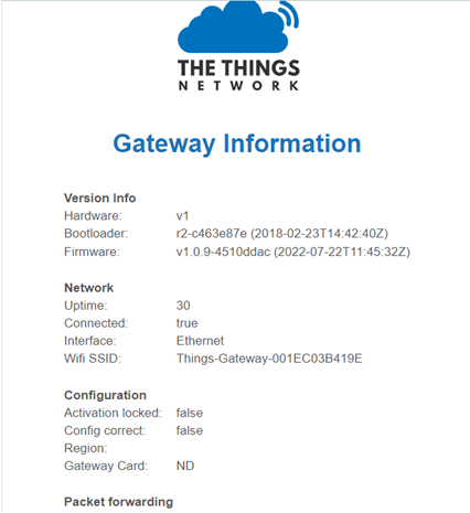

Oh yes, i guess i got confused with TTN vs TTS. I am trying to activate TTN-GW-915 (https://www.newark.com/the-things-network/ttn-gw-915/accessory-type-wireless-gateway/dp/05AC1807?gclid=Cj0KCQjw48OaBhDWARIsAMd966DDjWai6in7EPtGP1C7wyi76yC4tzGeAvLOWBfuFZZ4QD5qPV7UVr8aAqWXEALw_wcB&mckv=_dc|pcrid||plid||kword||match||slid||product|05AC1807|pgrid||ptaid||&CMP=KNC-GUSA-PMAX-Shopping-High-ROAS) on my community account by following various threads and instructions. I am stuck at 3rd LED blinking fast. When i check gateway info: it shows me Gateway Card: ND and Config Correct: False.
Firmware version: 1.0.9
Hardware: V1
Bootloader: r2-c463e87e
Finally yes, but for now exploratory.

Following is my gateway info:

ND (none detected) could also be an issue with the card seating - again historic thread posts around this with recommendation to extract the concentrator card, clean the connectors and reseat to try again… if fully reseting device before trying wireline activation before using wifi didnt work…
Apart from the challenge of having volunteers track details across various threads, this would appear to be the first time you’ve provided the gateway details screen shot.
And the screen shot speaks a 1,000 words - no gateway card - whilst I haven’t set one of these gateways up (yet), I know the forum has many instances of people being told to check the seating of the card as this is one of those little foibles of the design that is well known.
But we’d never ever have known it was the card without the details when you were pushed. So please slow down and just give all the details, don’t cherry pick what we think we might need to know.
