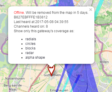

Actually… There may still be some problems with this. Not that this is a useful configuration anyway. But I see the following on the ttnmapper.org
This morning I disconnected the new gateway from the network. The above gateway worked this morning at a time later than the time mentioned in ttnmapper.org. At the time mentioned in the screen shot both gateways were connected to the network. But why would ttnmapper say that my first gateway was last hear at 04:39 ? And where does it get this information from ?
Kim
PS. The new gateway is disconnected and will go to it’s new home in Maaseik later today. But from the message in ttnmapper.org it does appear that some problems occur from having two gateways behind the same natted address even if the problem is not that it doesn’t forward packets.
