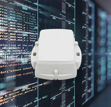

  • LGT-92-LI
    ** I like it is already in a case and
    ** has a USB Port (for later solar panel)
    ** but “which target for real time tracking with short tracking uplink” → this is what I don’t need. Is it possible to get the complete configuration for the LGT-92-AA and configure it the same way?
  • LGT-92-AA
    ** no case (well could 3D print it somehow from thingiverse
    ** matches my use case more “This is designed for asset tracking where only need to uplink a few times every day”
  • RAK 7200
    ** already in a case with USB plug
    ** seems to fit my use case from the configuration already

I would not recommend this device. The device has very immature firmware and suffers from performance issues in both LoRa antenna circuit as well as GPS performance.
As a contribution to your list you may consider the Oyster tracker: Oyster2 Battery-Powered GPS Tracker | Digital Matter
I have both. Dragino is much better as sleep mode (and wake-up thanks to accelerometer) is implemented.I confirm RAK7200 is poor in term of antenna and battery duration…

@oberour which version of Dragino do you have? With our without case?
I use Oyster LoraWan on the TTN, no subs are applicable. They work well.
So you will know it’s been stolen and possibly have some sort of idea which direction it’s gone in, assuming the other persons gateway is always there, but after that, it’s entirely up to gateway coverage …
With case LGT-92.

So I think I will go for the LGT-92 with case. Which means some configuration efforts to change it to long term tracking.
The Oyster looks like a good product but isn’t chargeable from outside (due to waterproof case) for later solar panel use.
The Oyster use penlight batteries and you just swap them out, I have been running for more than year on one set. There spec is 3-4 years on a set.
My Oyster moves 3-4 hours every day. They are also easily configurable.
