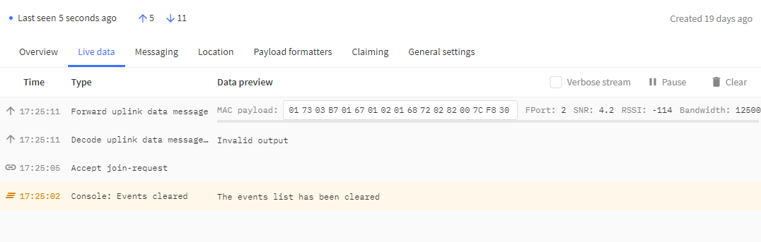

I receive the data in the console but it does not decode them correctly.
01670107026848037326DF04740109
It only shows the received bytes but does not show the fields for temperature, pressure, …
Payload format is set to Cayenne LPP.
How can I proceed to analyse my problem?

Console always shows raw data without a decoder. You need a Cayenne LPP decoder.
Or use mydevices.com App.
The Cayenne LPP decoder is one of the choices in the ‘Payload Formats’ screen.
oh, okay, i didn’t know that. Long time ago i looked at the menus…
payloadformats
integrations
Dont assume I am an expert mind, I only found it myself a couple of days ago.
Cayenne LPP is already activated in the Payload Format
