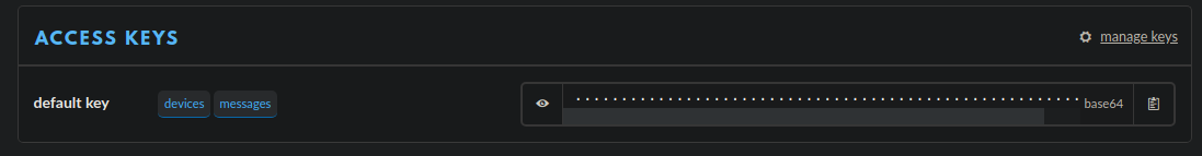

Because I’ve used as "password": "{{TTN_app_pw}}", the password provided in TTN application overview
The {{}} variables are stored in the Postman environment in order to make easier the HTTP requests.
And I’m not sure whether this is the required password because the FIWARE docs doesn’t specify such things.

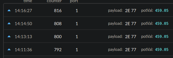

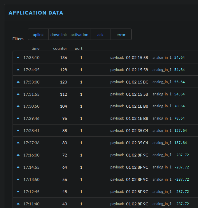

Could I fix my sketch just to use CayenneLPP and encode the payload in another different way?
