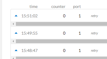

My device shutdowns every time it sends a message and thus the frame counters are not the same in ttn and device (I have unchecked the frame counters count in ttn but sometimes it does the check anyway…), could I possibly change the fcnt from the device to a different number?

I couldn’t find anything in the API documentation to change the fcnt, the counter is always zero
thus i have unchecked the frame counters checks in the ttn which is not recommended
