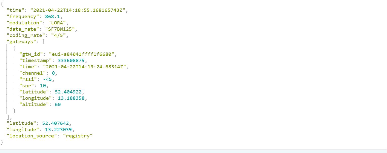

What leads you to think you need to change the DR?
RSSI of -45 is plenty, if not too much - how close is it to the gateway?

What RSSI / SNR do you get when itâs 2km away?

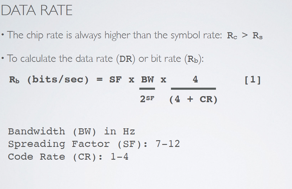

i can change DR from console but i have question.
now i am at DR=5 what is the maximum or minimum value should i setting. i live in germany (Europe). in TTN topic i read about DR depending on Transmitting power, band width and spreading factor. when i change the DR is affected only SF or other values like BW and trasmitted value. what is you opinion as expert in LoRaWAN

No! The decision is made by TTS and transmitted to the node by MAC-command. The gateway measures RSSI and SNR and tells these values to TTS.
