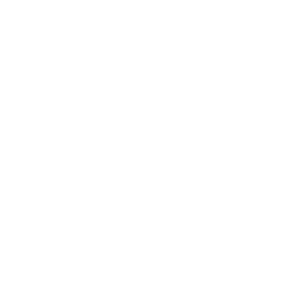

Here’s a summary map of Europe with the 433MHz gateways showing:

The image you attached is just empty white.

I think between the white square and the fact that there aren’t gateway frequencies on the main map should tell you rather a lot about what is in general use. TTS & TTNMapper are open source so you can make the modifications & submit a pull request.
