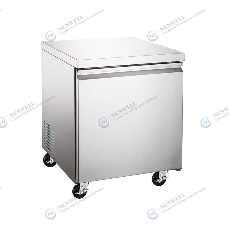

  2. what if the cooler is covered by a steel like this.
    cooler
  3. You have mentioned there are 5 that don’t work reliable. Is it because of the enclosure?
some are just laying on a shelf in the fridge/cooler others are mounted with magnets
either steel or aluminum covered double walled thermal insulation bodies rf escapes via the rubber door seals
the coolers double walled bodies are the first part and then two concrete walls we are planning to install a new gateway closer to these next month that will fix the issues
you need to expect some issues if you do it the way we did
you can not expect to get any range out of your nodes from inside the cooler
if you only install the probe into the cooler and the rf outside you will get better range
