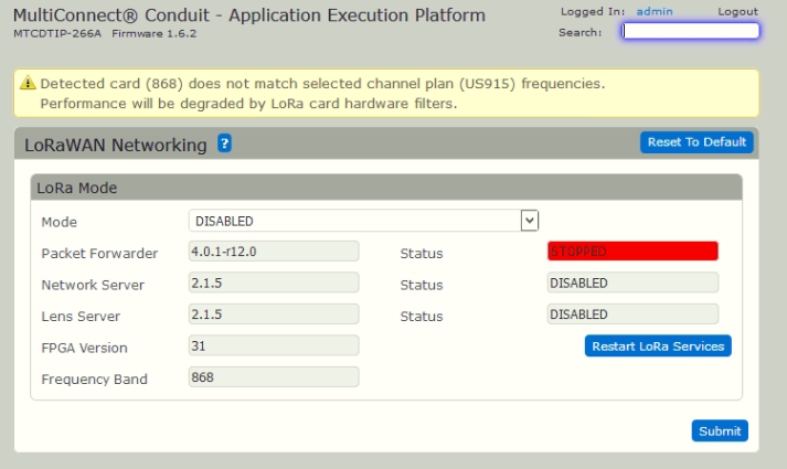

I am having the same issue, the AEB packet forwarder status is not showing the kersing packet forwarder status, and i get this massage on the page :
I am not really interested in showing the actual status of the packet forwarder on the AEB page, i just wanna ask if this warning regarding the US frequency is an actual issue; BTW i am using the 868 plan.

(Jreiss) #4
The status block is looking for lora_pkt_fwd process to be running.
The name of the process has been changed with the installer so the status cannot be correctly displayed.
The warning can be ignored as the AEP settings are not being used by the ttn packet forwarder.
Reload the AEP firmware if you want to restore the original functionality.
