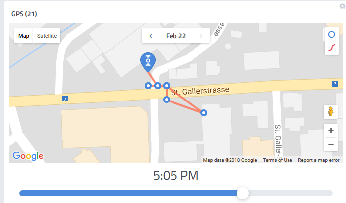

I signed up today again, got E-Mail and could integrate with Collos. Looks like RSSI method works.
It is visualised in cayenne and also in the ttn console.

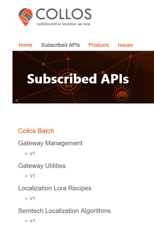

I did the integration for my devices / applications today, too, and it works, i get coordinates for my devices in ttn console. Precision not yet tested, currently it’s too cold here to walk around outside
In the collos API i see add / update gateway functions. What’s their purpose? Should i try to add my gateways with it?

There are really two types of GW out there: (1) the vast bulk of GW are V1 variants and produce time of arrival timestamps that are only accurate to microsecond level. (2) GW based on the V2 reference design which includes nanosecond level time of arrival hardware.
In a location query to the TDOA endpoint, you will need to provide the accurate timestamp from at least 3 V2 gateways. The V2 gateways generally produce these fine timestamps in encrypted form and in order to decrypt these timestamps, the system needs to associate the GW label with a decryption key.
There are two reasons to provision the GW- (1) to place the GW in a fixed, known location in the database and allow the query to remove the location of the antennae from the query, (2) to provision the fine timestamp decryption key to be associated with that GW.
The TDOA endpoint will fall back to using RSSI (signal strength only) if the receivng GWs are not at least 3 provisioned V2 GWs.
