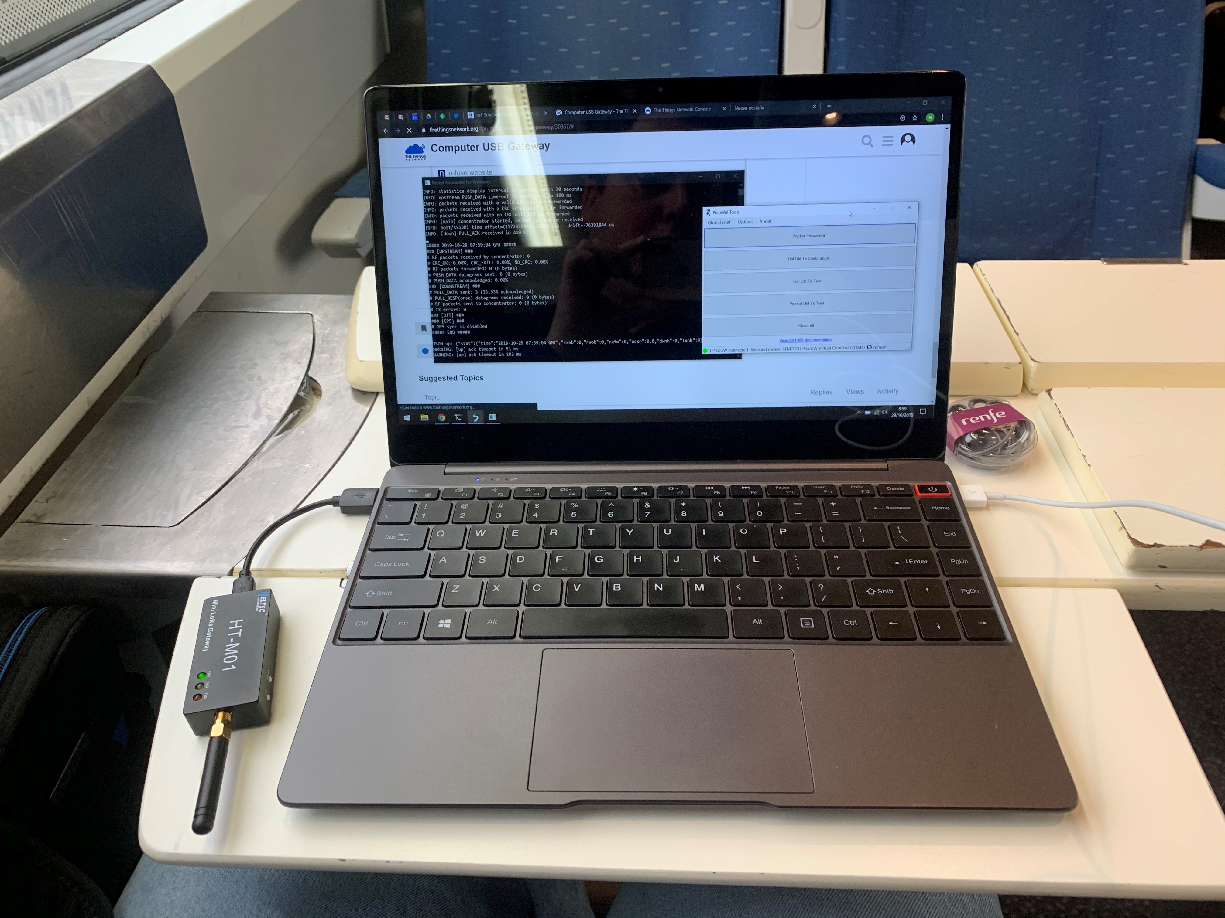

Heltec HT-M01 pico gateway
IMG_0609
USB interface without latency problems of former FTDI US gateways.
About 100€, great travel gateway.
The packet forwarder is already compiled for Windows.
For the n-fuse USB LoRaWAN Gateway (LoRa mPCI-E card with USB-Adapter), there is also a Windows Software available with GUI that you can download from the product page.
