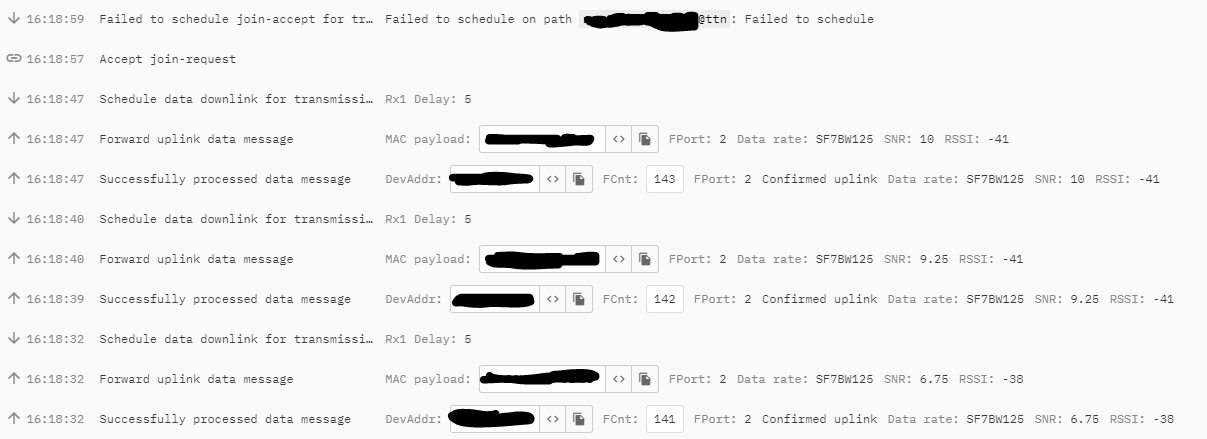

Up until very recently (3 weeks ago) everything has been going very smoothly with my array of nodes. Then suddenly one of them went offline for around 12 hours. Then last weekend they all went down, I have tracked this down to the fact that they do not receive the acknowledgment from a confirm uplink. After 3 failed confirm uplinks my node will attempt to do a join request, which if it fails it will conform to the back off timer and not resend a message until the next 24hour period. I cant work out why a join request would fail. The node is no more than 10m away from the gateway. I am using the (GitHub - Lora-net/LoRaMac-node: Reference implementation and documentation of a LoRa network node.) SemTech LoRa stack on an STM32WLE5. If anyone has any idea why this has just started happening some insight would be greatly appreciated.

Might be too close! Try moving further away/have absorber inbetween - I assume this is just a test node rather than the full array of field deployed nodes? If so wont explain all the others…

Yes, this was just for a test node, the others are all further than 100m away.
I am sending the max of 10 confirms per day, so I will reduce it to 1 per day.
The TX rate is due to the node not receiving a response so trying again straight away, I shall add a delay to ensure that it complies with the FUP
