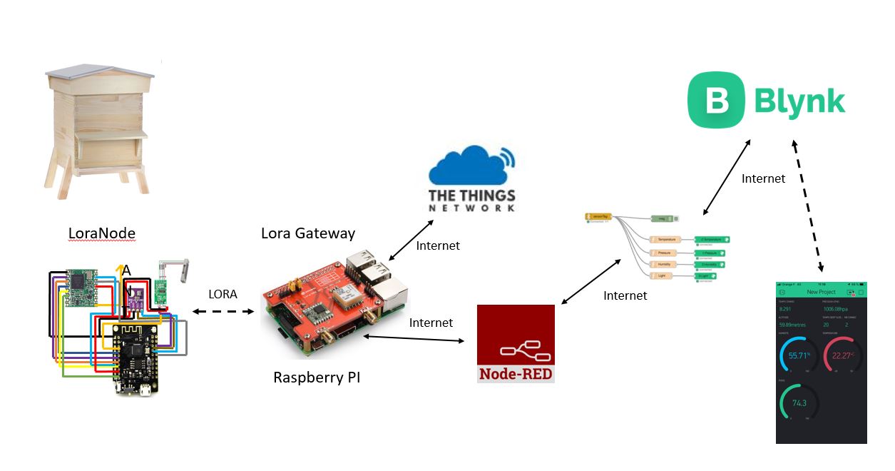

I started a year ago to develop a connected hive. The prototype I am currently working on, uses a Lora communication system through the things network to node red and finally the Blynk application

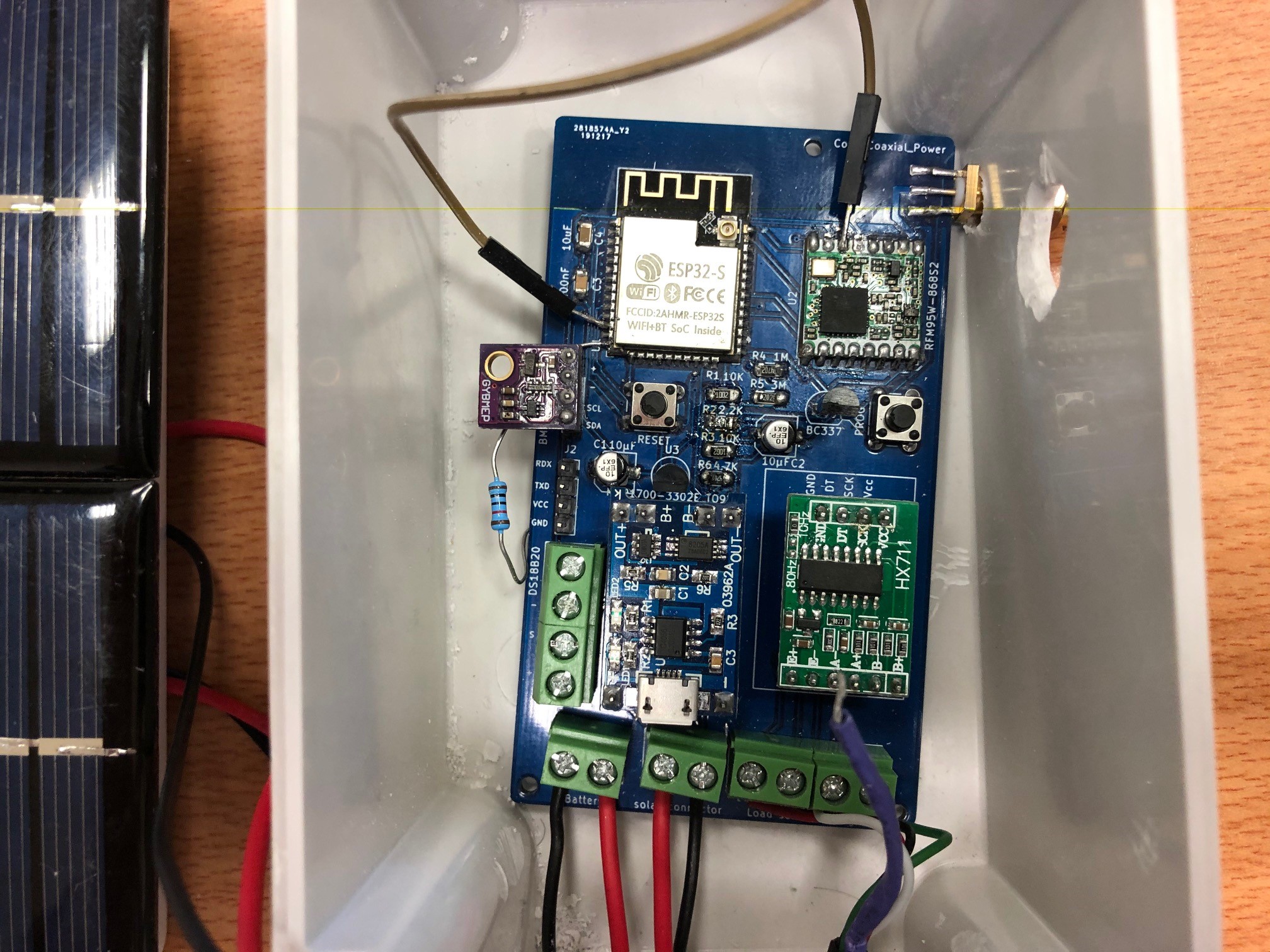

Starting from my prototype, I developped a PCB with Kicad. In this PCB there is a ESP32 module, a RFM 95 lora, Deepsleep mode, load sensor with hx711, BME280 sensor and multiple DS18B20

My PCB is now working after some time spend on it!

Quite interesting! Would you share some more details about this project? I mean code, PCB, …
