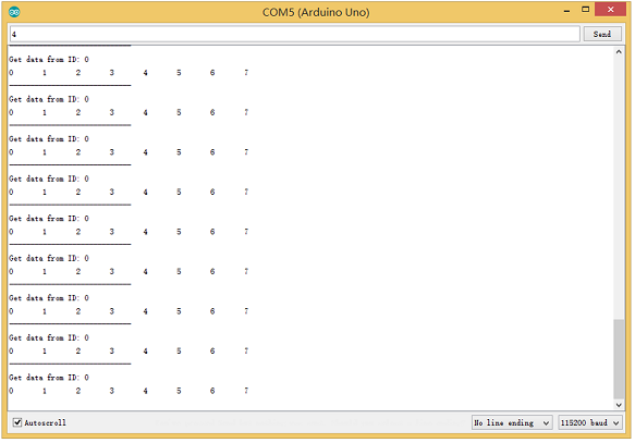

That’s an example from CAN-BUS shield library for receive_check. So I want to send the received data to the ttn gateway via ttn uno.
Here’s an example of the data that I want to send which is not a lot. and it doesn’t have to be so fast.
Thank you so much!
It is hard to understand the specifications from a screenshot.
It’s 8 bytes? 8 integers? 8 longs?
Once per hour? per day? per minute?
Dear UdLoRa,
Thanks for the reply.
It’s 8 bytes and I want to send it once per 5 minutes.
Thank you so much!
