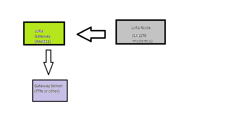

@LoRaTracker
So I can’t implement top two blocks alone without having any server?
No, and you’ve been told this several times now.
The diagram is fundamentally correct, but you can’t do the top two by themselves, which means you need to learn LoRaWAN.
