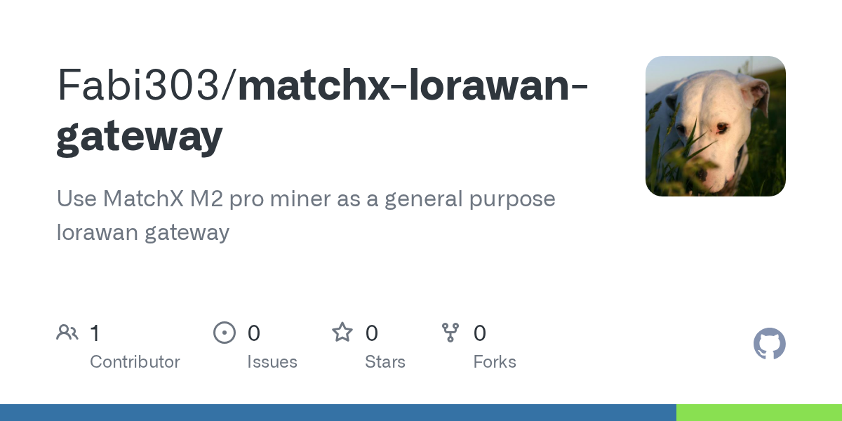

I am currently working on a clean alternative:
