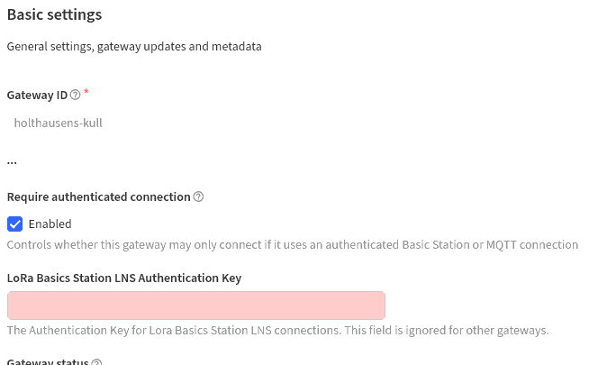

I’ve got a question regarding the (now gone) LNS key:
After claiming the device a LNS key was generated and showed up automatically in the general settings of the gateway.
Looking at the settings of my TTIG now shows an empty LNS key (see picture below, I’ve marked the empty field in red). Nevertheless my TTIG in still connected and is still successfully forwarding packets.
So is the LNS key still stored and just not displayed for security reasons (and neither a placeholder) or should I be worried that soon the gateway will disconnect due to a missing LNS key?
Here’s a screenshot of (that part of) my basic settings:
lns_key
That’s being covered in this issue; Gateway console field 'LoRa Basics Station LNS Authentication Key' is empty after recovering from "An unknown error occurred" · Issue #4335 · TheThingsNetwork/lorawan-stack · GitHub. Please add your comments there.

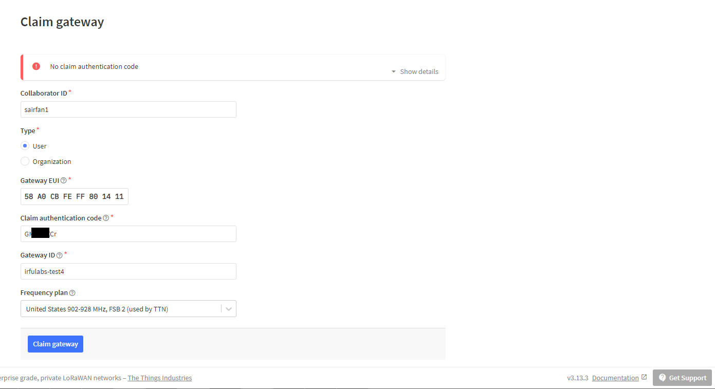

So my TTIG was already removed from V2 now when i created new Gateway on V3 it shows status disconnected, when i try to claim it, i get error message “No claim authentication code” I’m sure I’m using correct Claim authorization code which i got from TTIG access password
To be brutally honest, this is where you are at, you deleted your gateway prematurely and then you put “I added it to V3 Console it shows disconnected” and then you tell me I’ve got the wrong idea about your message???
Why could you have not used the correct language ‘claim’ with the error you were getting from your first post above.
Your last thread ran for 32 entries, if you can’t respect the other forum members time, please do not expect much in the way of help.
If you read this thread, you’ll see that the error message if it’s not typed in correctly is “Claim authentication code mismatch” whereas you are reporting “No claim authentication code” which suggests you didn’t actually type in the WiFi password (I’m not sure wha the TTIG access password is, accuracy in terminology is everything).
I’m sorry for my poor English/understanding, I highly appreciate everyone on this forum helping us.
As its said in the help that Claim Authentication code is WIFI code on the back of (TTIG) device
I’m attaching image to show how I’m trying to claim and what error message i get. (Please let me know if i should i hide any information in the picture)
gateway_claim
You have the middle part of your EUI the wrong way round
It’s FF FE …
As I said, it’s all about the detail …
Thanks my gateway was connected.
