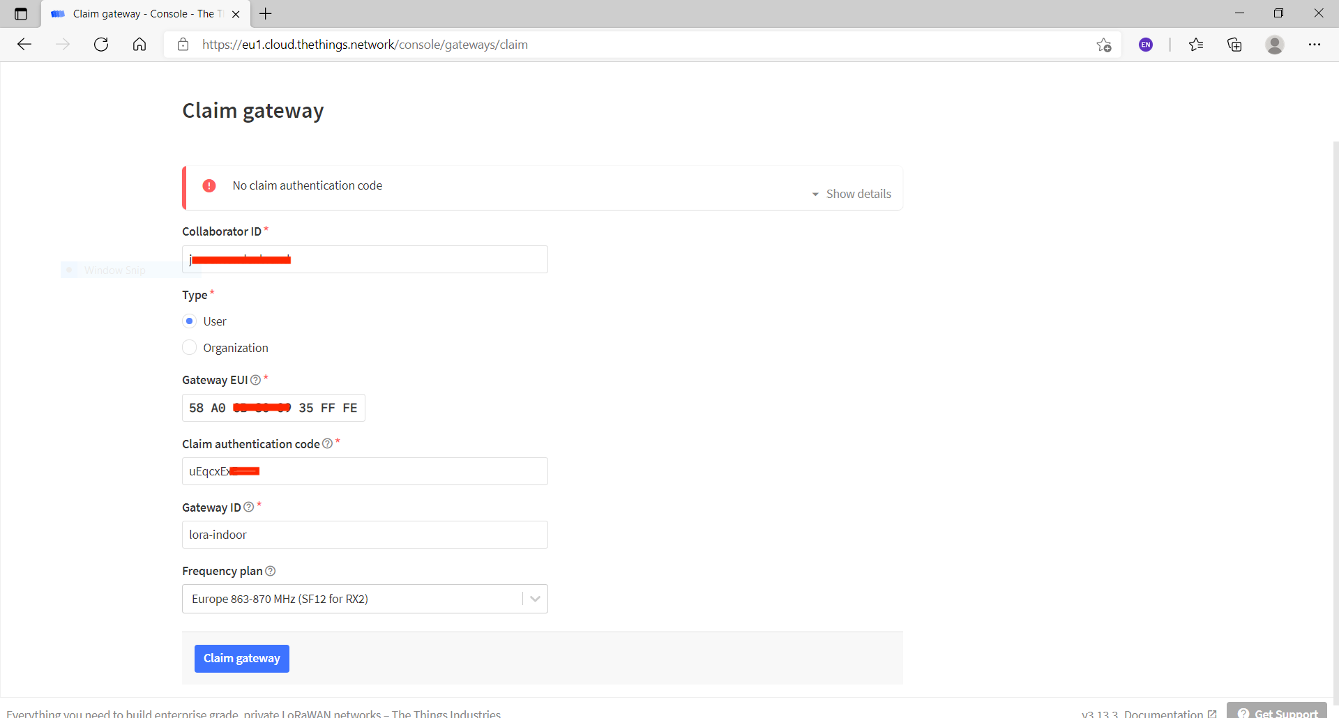

I’m also trying to claim my TTIG (which is registered and working in v2) to v3 following the procedure. However, no matter what I do I get a ‘No claim authentication code’. I am 100% sure the correct WiFi-password is inserted. Please help…
Capture
As it’s still being worked on, I have seen a couple of instances where the error message wasn’t entirely accurate.
Given the rather generic nature of your gateway ID which has to be unique across the entire of TTN, you may want to try again with something a little more personal.
Also your GW EUI looks a bit iffy - can you check it please (would normally expect to see FF FE as middle order bytes)… also no need to hide this as the info is available in the public domain for anyone having a device whose signal is picked up by your GW!
Good spot - I can just about see how a non-matching pair of EUI & WiFi password could be passed off with that error message.
@jeroenvandenbrand, where did you get the EUI from - or which instructions did you look at?
Solved it!! It was indeed an incorrect EUI. I inserted the FF FE characters at the end of the EUI that is printed on the back. It should be in the middle, as the guide says. So 100% my own fault… Running on v3 now. Thanks for the fast and good help!!

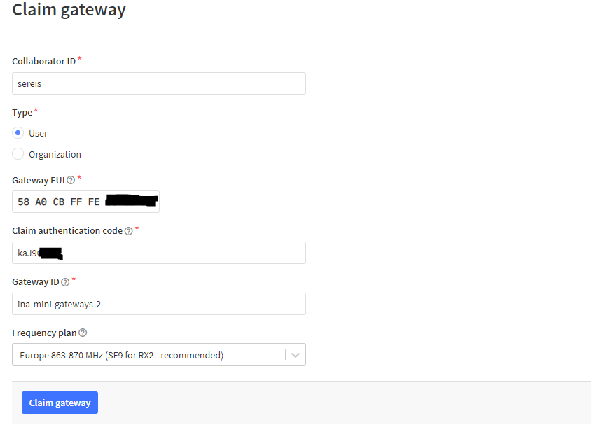

I deleted my TTIG from V2 and then tried to use it in V3. See picture:
claim ina
I have checked all codes (eui) three times to make sure there were no typing errors.
I then performed a powercycle and unfortunately the TTIG is still disconnected. I have even waited 72 hours and it has not changed. The TTIG blinks green and nothing more.
Maybe you have a tip on how I can proceed.
Could you PM me the EUI of your gateway? I’ll check in the background
