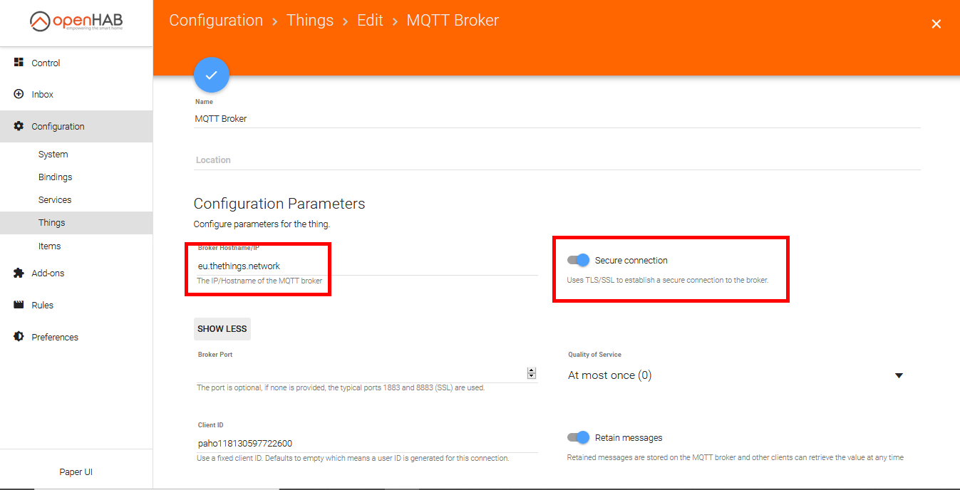

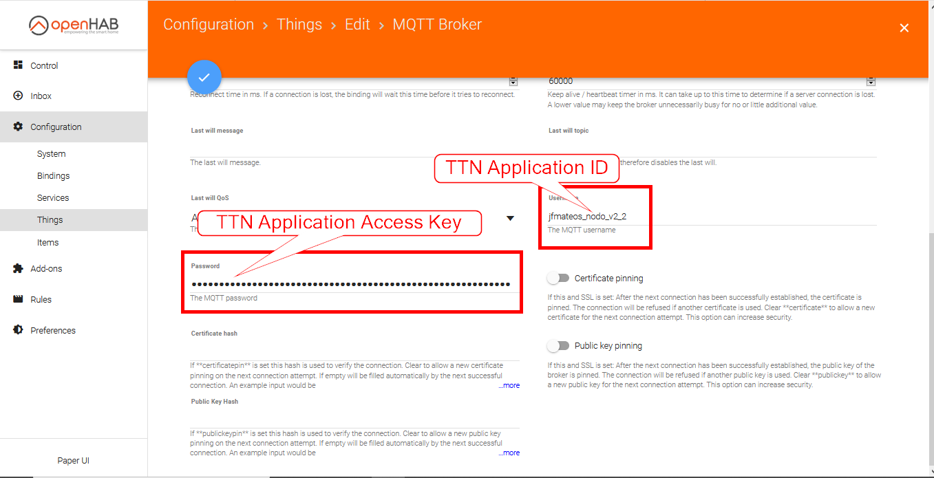

This is the configuration I use in openHAB
imagen
imagen

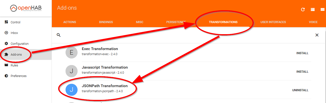

Then I install de JSON path transformation binding
imagen

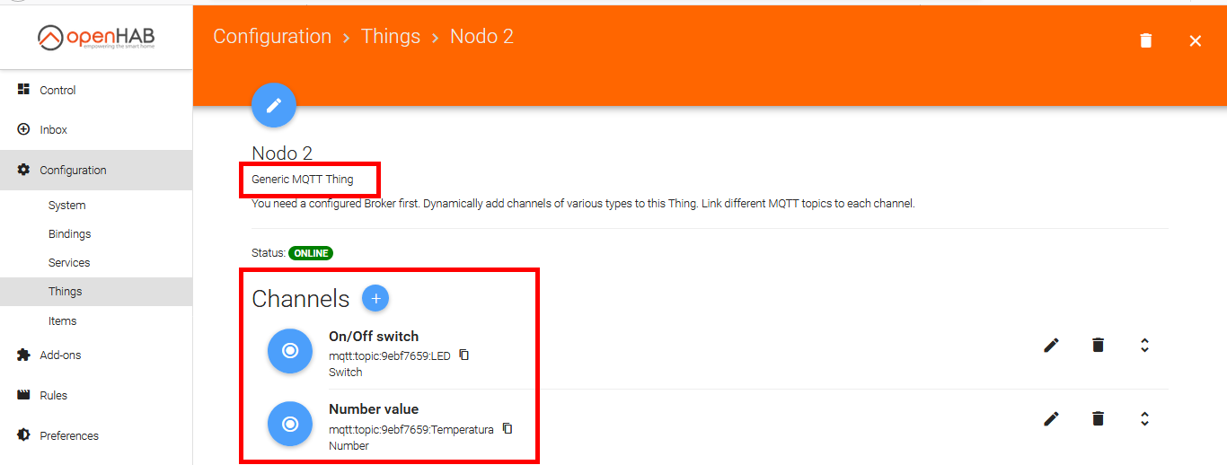

And finally I configure an MQTT Generic Thing with its channels
imagen

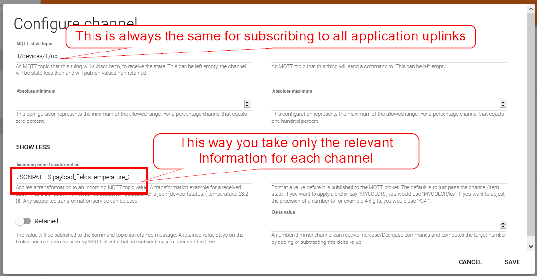

And in each channel I subscribe it to the full uplink topic and then get the data with a JSON transformation
imagen
