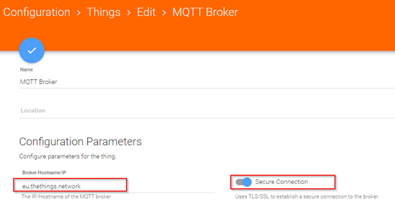

Dear Miguel,
This is the configuration I use in openHAB

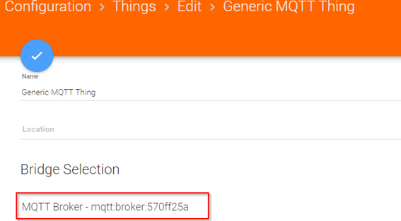

And finally I configure an MQTT Generic Thing with its channels

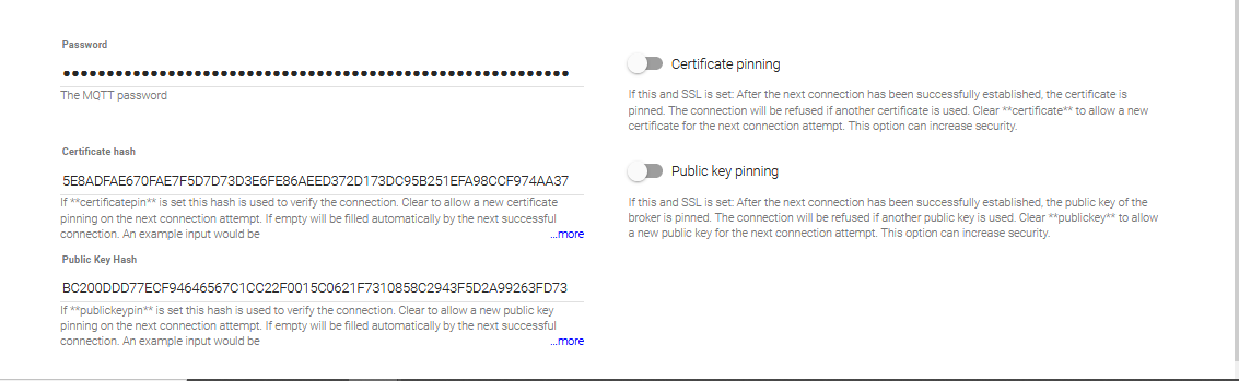

Hello kersing, jfmateos,
Thank you for your answer.
I have compared your configuration with mine and seems OK.

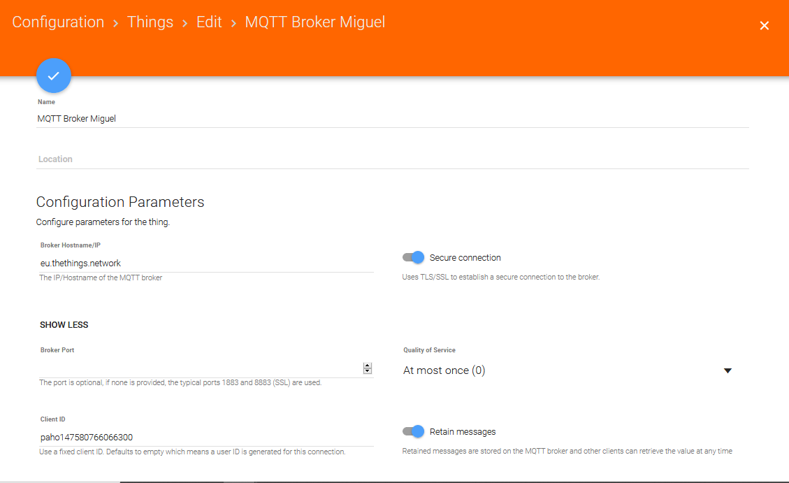

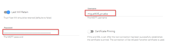

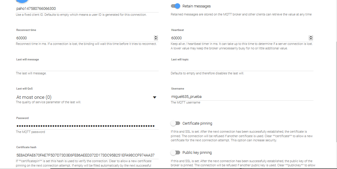

  1. Broker MQTT

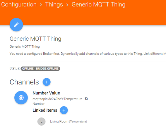

  2. Generic Thing

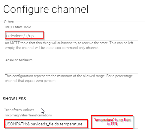

  3. Channel
Is it neccessary activate anything in TTN applicattion?
I dont understand why the broker is looking for a topic called “homeassistant” since i have not configured anything with that name.
Thank you for your help.

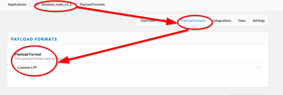

Dear Miguel,

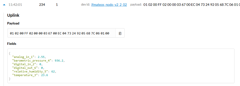

Are you sure temperature is the name of the field? Take into account that TTN usually uses a raw payload, and will only decode it as payload fields if you select a payload format. For example, i use Cayenne LPP
imagen
With this payload format, a typical packet will decode this way
imagen

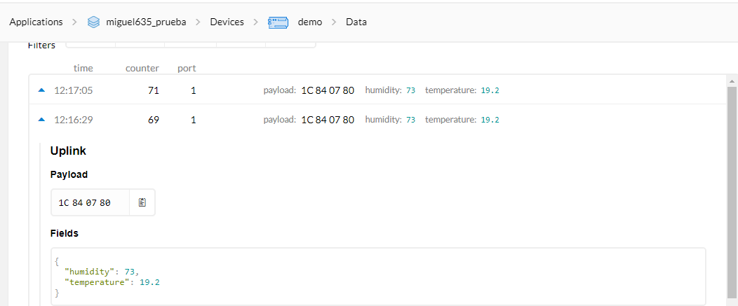

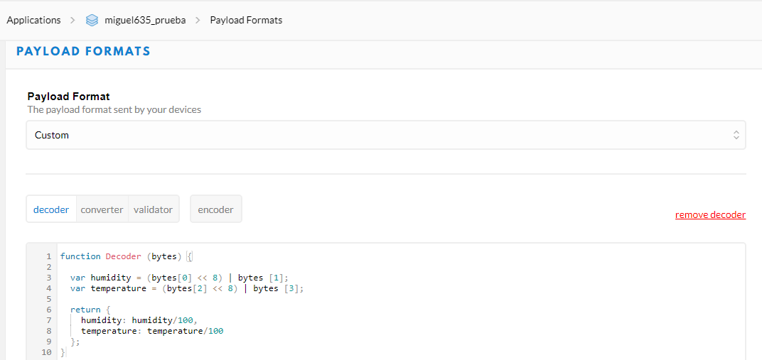

Hello,
I am using a custom payload as follows:
And this is how is decoding the payload
I am going to test with CayennLPP to check if that can be the problem.
Regards.

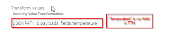

Your sending sensor packets every 15 seconds ?
Ok I see the problem, you have written payloads_fields, but it should be payload_fields
Hello again,

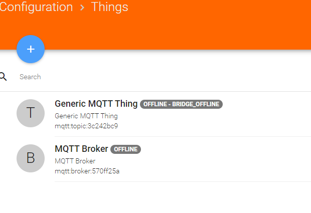

I have fix the error in the payload but the broker is still Offline:
Regards.

Please compare yours
imagen
with mine
imagen
You are right, sorry.
But still Offline.

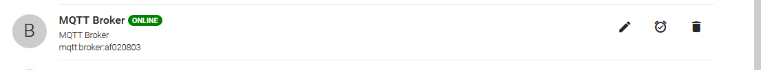

Yes, the MQTT broker should be online

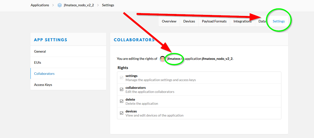

Miguel, would you mind to allow me (jfmateos) as collaborator of your miguel635_prueba application (through the Settings tab) to check it
imagen
Sure, done.

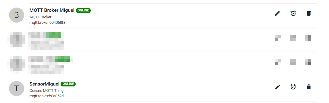

Dear Miguel,
I have just configured your user in my openHAB installation and the broker is online.
Please check the full configuration carefully; if everything is OK, I would bet for a problem with the firewall or other network issue
imagen
imagen
imagen

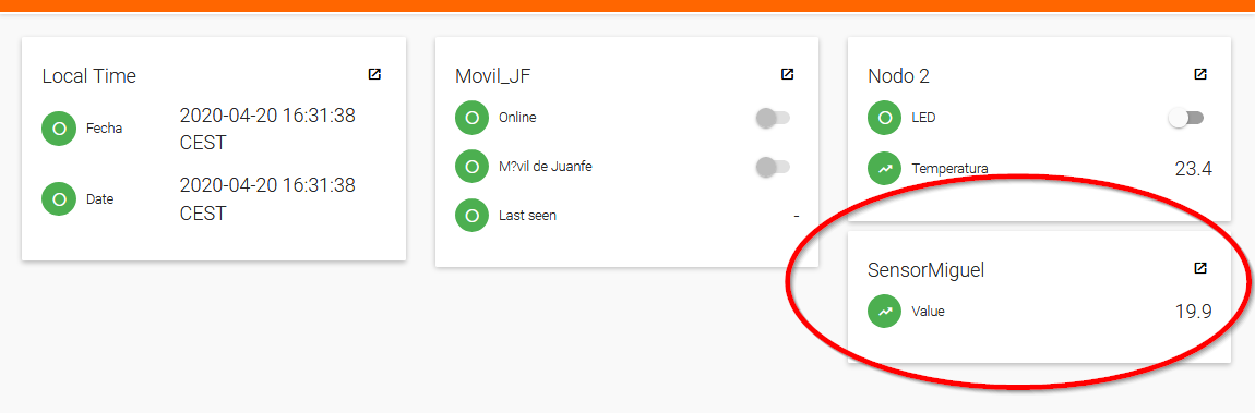

I have also configured your sensor and it is working properly
imagen
imagen
