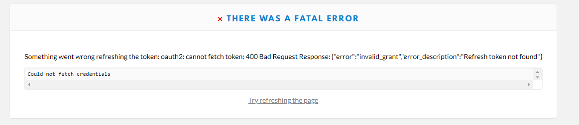

Console Fatal error after some minutes of inactivity
Hi guys
I´m getting this error message in the console after some minutes of inactivity
This happens in this links (for example)
https://console.thethingsnetwork.org/applications/demo_telemetria_1/data
https://console.thethingsnetwork.org/applications/demo_telemetria_1/devices/smart_human_board_1/data
Pressing F5 (refresh) in the browser recover the connection.
What can be wrong?
Thanks in advance.

Whilst I sympathise with the frustration, most of what you do has nothing at all to the console fatal error which is entirely about the information the browser has about its login expiring and both ends not quite managing to sync up.
If I’ve got anywhere between one or 10+ TTN console windows open doing tests and monitoring, over the space of the day, at least one of the windows will end up with a fatal error, sometimes more. My main development platform is macOS on which I run Safari & Chrome but I also have a Windows 7 PC to hand on which I run Chrome. Any or all of them can end up with the fatal error.
The vast majority of the time I simply refresh the browser page. If that hiccups, I close the tab and reopen a new tab.
At no point have I seen this issue affect the TTN back end that results in the network server having incorrect data which is what would be needed to prevent it being accepted in to the TTN system from your gateway and then on to your application.
I’ve no doubt something is going on, but given the chain of code that would have to go horribly wrong between a browser console session and the authentication & decryption on the network server to stop packets uploading from your gateway, I suspect you are the victim of a set of co-incidental circumstances.
