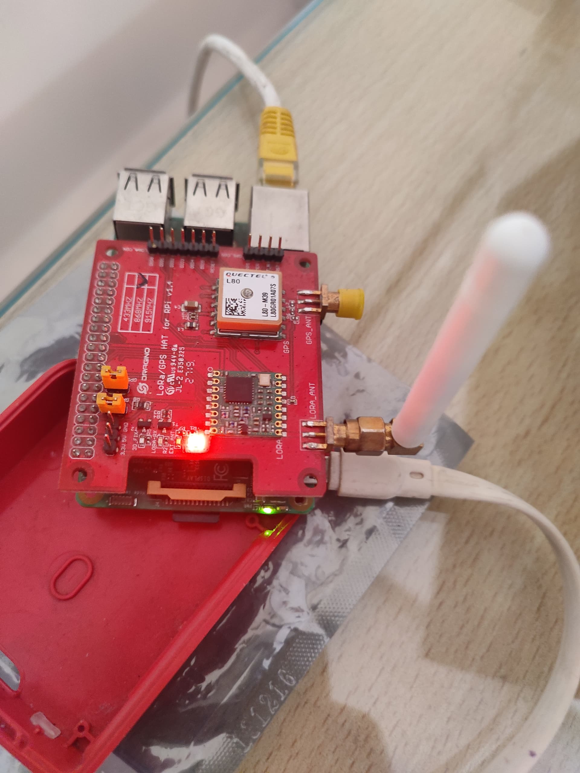

I have a Raspberry Pi HaT from Dragino which is connected to the network. I can see it online on the ttn server but the end node does not connect.

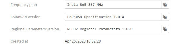

I have created an end application and registered a device there. I have kept all ‘00’ for the Appeui part and registered a device manually on TTN.

Though, I have to say that I registered the end device manually and could be that I might selected some wrong value for firmware version and other stuff but it should work btw.

As you will no doubt be aware from following the tutorial to create the gateway, you have a Single Channel Packet Forwarder which is disruptive to the network and are not suitable or welcome for connection to TTN.
And that is the reason your MKR WAN won’t / can’t / could one day connect - it is using 8 channels and you have only one.
Please disconnect it immediately. You can read more here:
