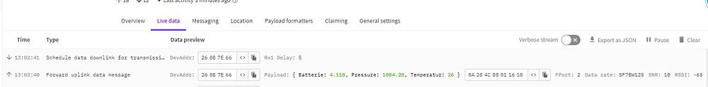

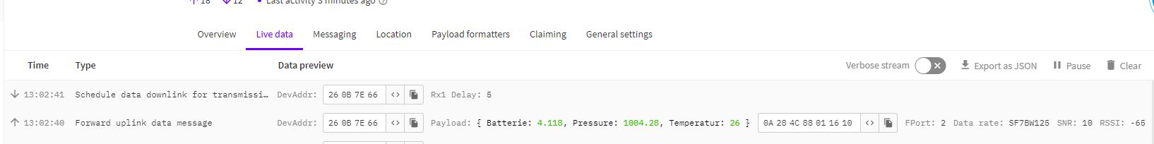

here is still pressure and temperature and battery with it.
