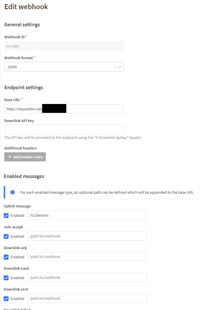

Hi everyone, I created a testing webhook to forward the uplink data like the following

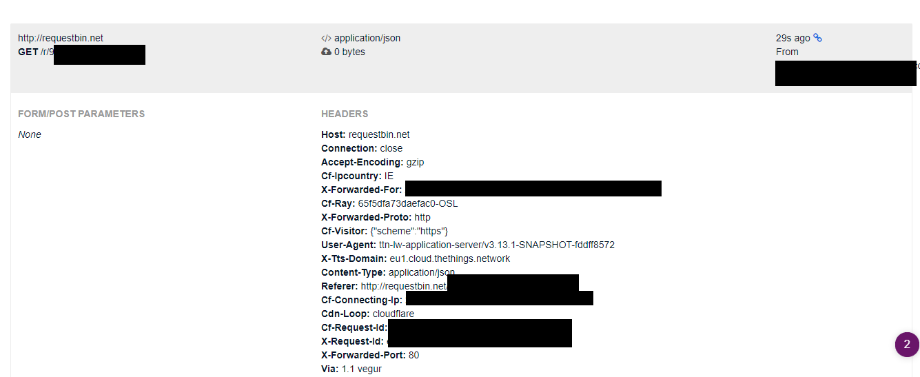

TTN application live data shows the uplink data, while the requestbin messages are empty !!
What could be the missing thing here?

Just adding one more piece of information, I’m sending data from 10 sensors.

yes i did. i tested on requestbin but other person tested on the real web-server and we both get empty data.

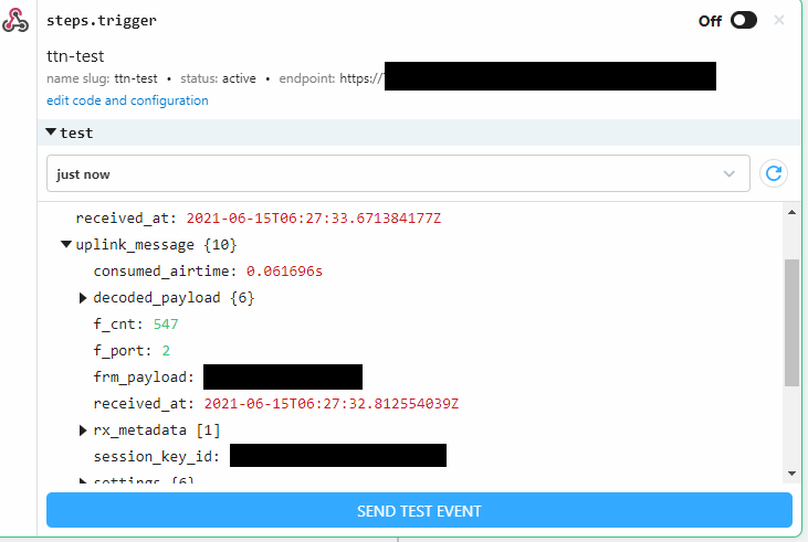

Hi Nick, strangely when i used pipedream to check I was able to catch the data !!! any idea what could be the reason to prevent binrequist from getting the payload ?
Nope, but I did check it in Pipedream last night as I have that bookmarked as well and it worked.
