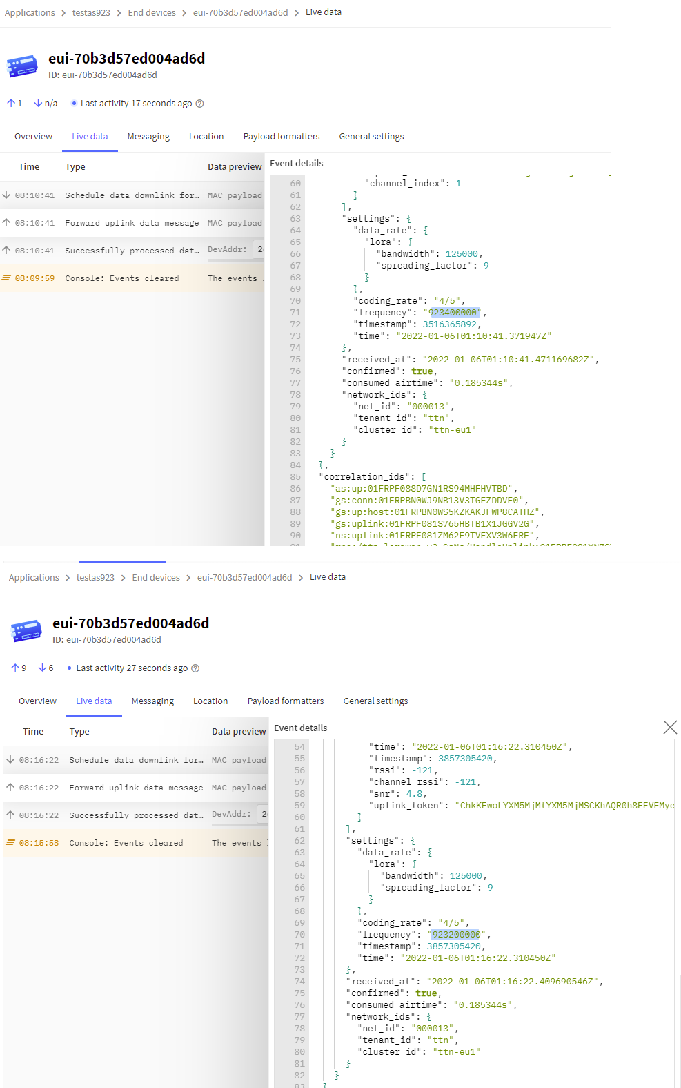

LIVE Data of application.
We only receive data with the frequencies as923.2 and as923.4. All remain the frequency don’t receive data in live data of the application.

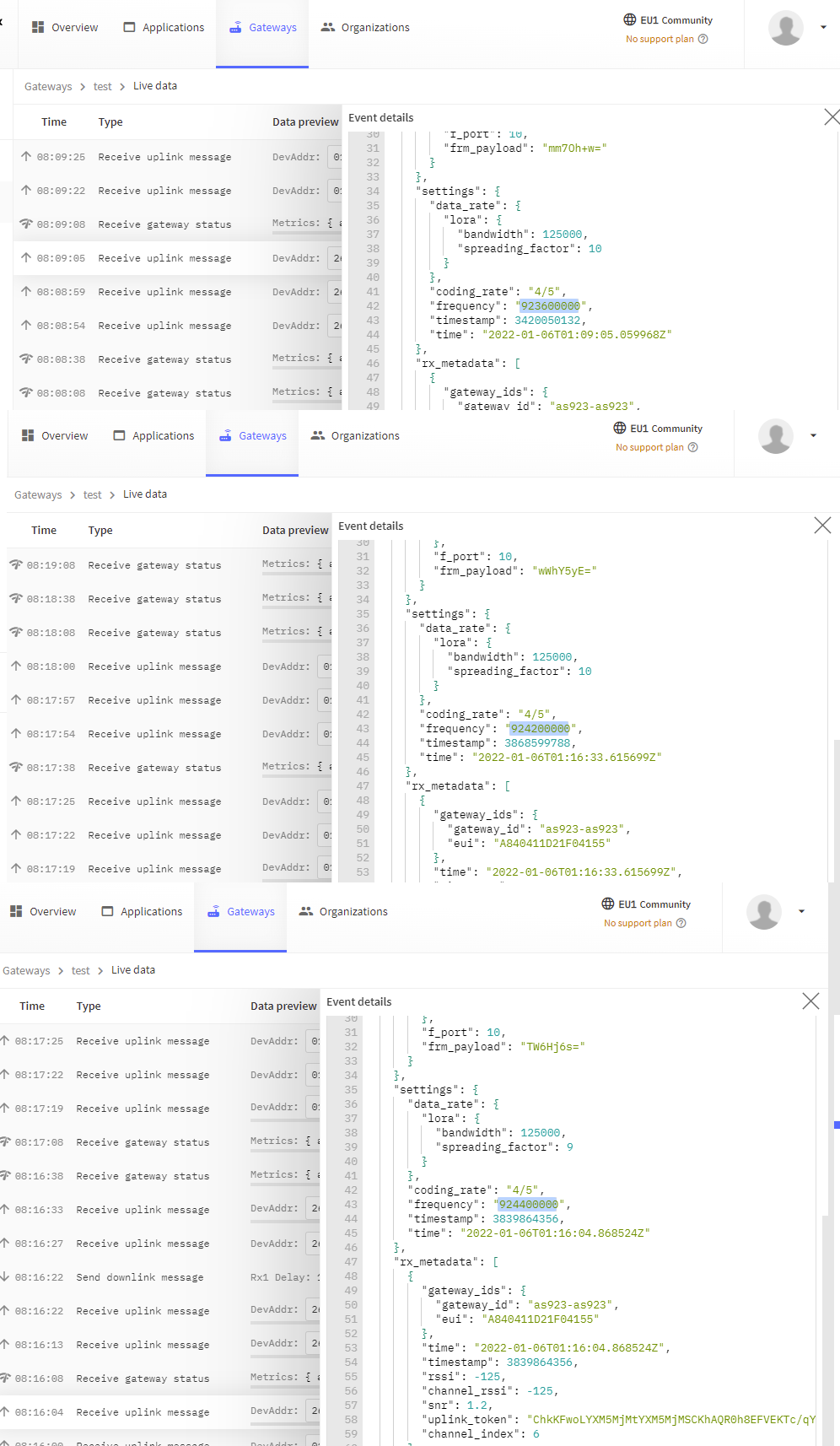

LIVE DATA of gateway.
We receive data with all the frequency of as923.
We think . Live data of application has a problem decode or filter. Do you have several examples about as923?

Edit: Actually a closer look suggests you are seeing several freq at the gw… are these all from same node or are these different nodes on same application? Tx interval on a couple of your images are a bit short implying Tx too often? Also one shows a Rssi at -125… right at fringe of Rx sensitivity…rare to see lower than -120/-121 in the console… If at edge of reception may be corrupt/fail checks and not get passed to application - how far are node(s) from gw?

we configured module Lora (RISINGHF RHF0M062-HF22) and we checked it. it’s correct. we used module RISINGHF Lora. The firmware is provided by the manufacturer. Can you check this module with TTN? (AS923). we used with server TTN V2. It’s OK. But After we used server TTN V3, it don’t receive data in the live data of the application. In this case, the live data of the gateway is received data with all the frequency by TTN.
