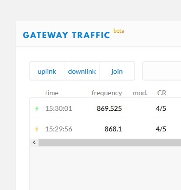

I have the things gateway that is up and running, and is receiving traffic, however none of it is coming from my end point!
I have successfully registered it, but it appears at ‘never seen’ , with a red dot next to it
it will say last seen with a few seconds and green dot, if I upload some simulated packets, but no traffic will ever show up from this device in my gateway- is this data going somewhere else?

open your TTN console in your browser and leave page open on your gateway / traffic.
now switch on your node… you should see your node (trying) connecting TTN OTAA
