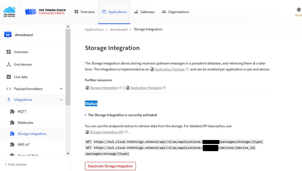

I have been trying for a while to read data collected in my account using Storage Integration V3, but not having luck. Just wondering if someone can point me to where I am going wrong?
Below you can see where I activated the storage.
Storage Int1
