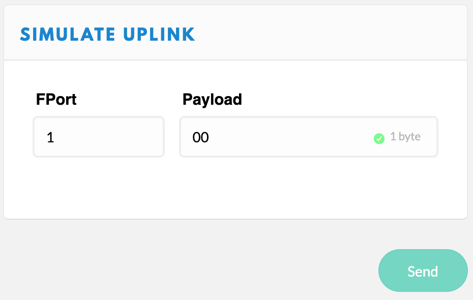

One can easily test by just returning some hardcoded JSON result in the Decoder, and then use Simulate uplink (with a random payload) on a device’s Overview page to trigger the Decoder and the integrations. No need to abuse the Fair Access Policy for that:
Simulate uplink
(To automate this, look at ttnctl devices simulate.)
