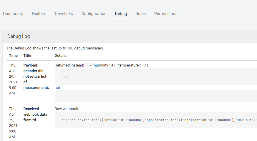

Apologies as new to the Things Network and have been loaned a Things Uno for testing which I’m using as a proof of concept device which passes temp and humidity to Datacake. The payload is being received by Datacake via webhook and shows in the debug as data received from tti but the debug shows “payload decoder did not return list of measurements”. Debug does show returned instead correct values for humidity and temp. The Dashboard fields just show zero. I’m currently using the same Payload decoder that was in V2 of Things Network which displays correct values from raw data. Any advice would be welcome.

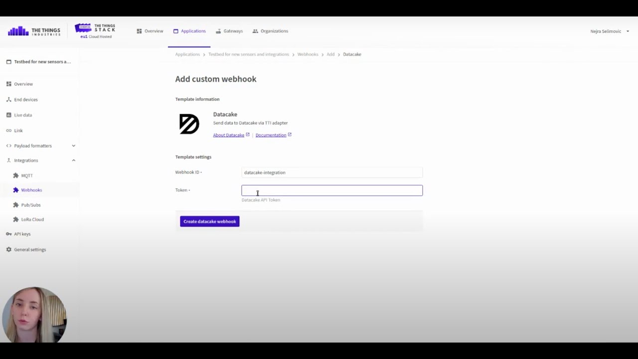

I hope you can help me… I’m trying to link from TTN-V3 to Datacake using a webhook but I don’t know where to find the required Token. I hope you can help me.

Thanks!!
Works like a charm… Now I can monitor my Smart meter via Datacake and TTN-V3.

Hi - did you get an answer? I’m seeing the same thing. Thanks
