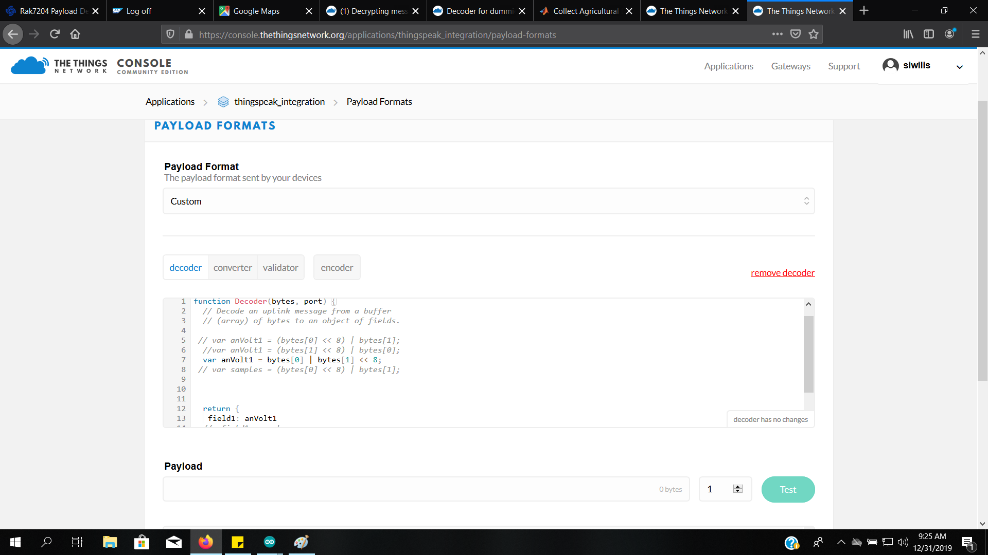

While “not successful” and a photo are, of course, not enough to help, a Payload Format/decoder is not mandatory so that’s unlikely to cause whatever problems you’re having.

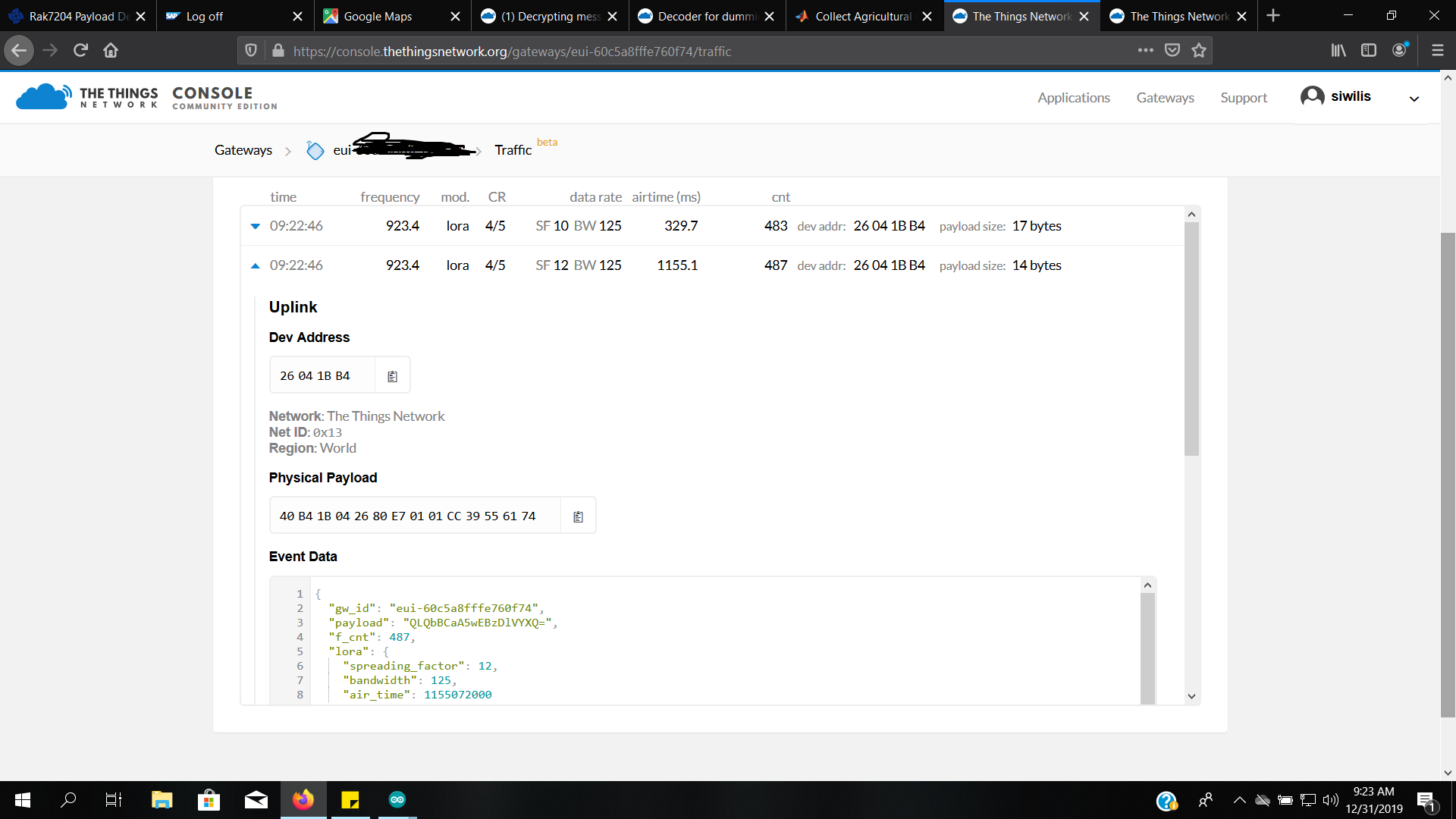

I’d first make sure that data is received on the gateway(s) and in your application, and when that works then see Payload Formats [HowTo] for some details on the decoder.

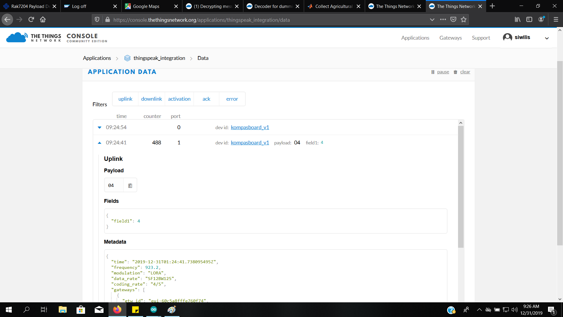

In TTN Console the device with DevAddr 0x26041BB4 receives just one byte. The code is for a different DevAddr, and sends 2 bytes:

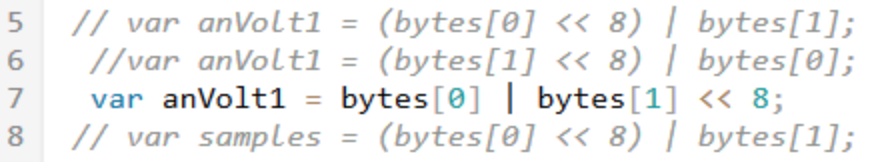

Next: the code, which is using message[0] = highByte(value), encodes the MSB first, so when decoding the value in bytes[0] needs to be shifted 8 bits to the left. In your decoder you’ve used a different order. For the Arduino sketch that you’ve linked to, the decoder should use line 5 (and the parentheses are not needed):
