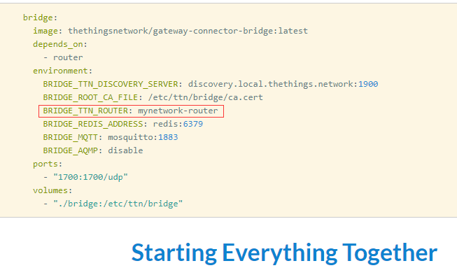

imageFor a fresh hand,it is better to add a port here,and add “put it below the broker: line”.
    bridge_1         |   INFO Routed connect                           Duration=582.612µs GatewayID=gw_test
    bridge_1         |   WARN Uplink not accepted by any northbound backend GatewayAddr=<nil>
GatewayID=gw_test
GatewayID=gw_test
GatewayID=gw_test
    bridge_1         |   WARN Status not accepted by any northbound backend GatewayAddr=<nil>
GatewayID=gw_test
    bridge_1         |   WARN Error in middleware                      GatewayAddr=<nil> GatewayID=gw_test
error=lorafilter: found Downlink payload in UplinkMessage
I have implemented my own account server.When i test ttn by docker,i encounter this problem.What could I do wrong?Everything else seems ok from the log.
I have set up a Private Routing Environment whitout docker and everything works well,i can get message from the device in my application.Weird.
I solve my problem finally.I just change this line to “BRIDGE_TTN_ROUTER: discovery.local.thethings.network:1900/mynetwork-router”.I don’t know if it’s the right way but it works.

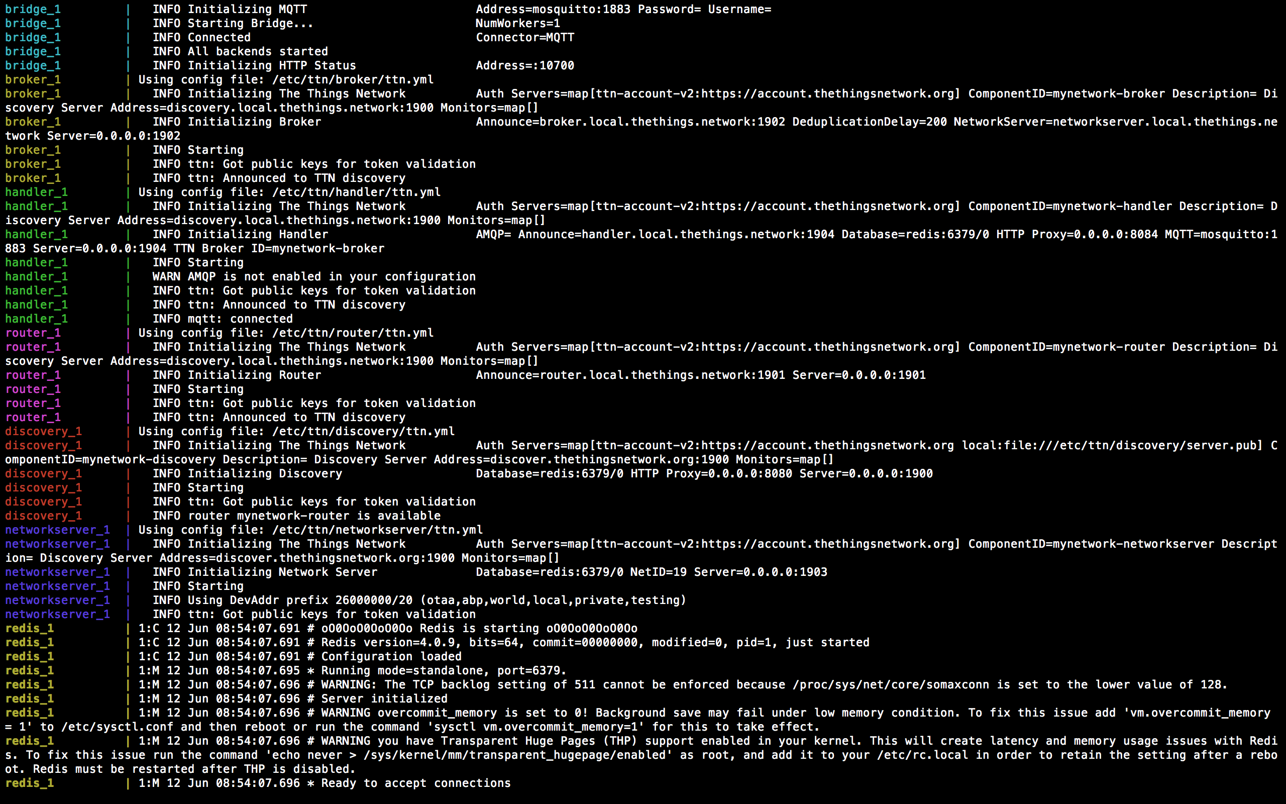

Hello all.
First of all, thanks for the guide. I’m running Ubuntu VM on mac. I followed routing environment step by step. docker-compose logs show me everything is ok, but the problem is when the only router is available for discovery. although broker and handler announced to the discovery. is it possible to help me?
