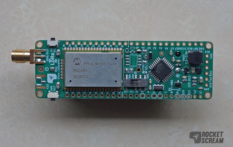

Hey have a look at this.
Also with the micro chip.
But I plan to redesign it because I don’t like the Mikrocontroller.
If somebody has a perfect low power Design please share it.
It uses a ATmega328, which is capable of very low power operation, so what the problem with it ?
If you tell us the problem, its easier for others to suggest something ‘better’
Not in the modern sense. Most of what an ATmega gets you is the least “porty” Arduino port, or the ability to run from a wider range of supply voltages. But in this case you need the SX127x which doesn’t have the ATmega’s higher voltage capability, and they design isn’t trying to use a lithium cell anyway. Most importantly, because it has an RN2903 there are actually two MCUs, which is one more than needed.
That’s not to say it can’t work or that it may not solve some problems the asker would otherwise have to solve on their own.
this RS node worked very good on a single AA cell
