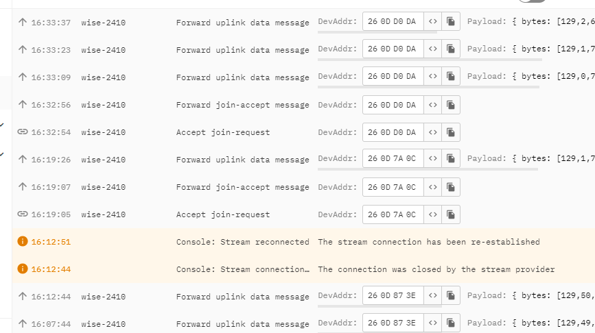

hye, I would like to ask is it normal when everytime we open our sensor the Dev addr will exchange each time?

The DevAddr changes every time you make a join, that is normal. After the join, the DevAddr stays the same until you make the next join. That’s what you see in your screenshot.

i see, what if im using a ready made sensor that have its own DevAddr? because i think before this i have connected my sensor and even i open my sensor it still show me the same devaddr the same sensor i use from the figure above result, and because of the changing devaddr…will it affect my data when i do integration with Node-red MQTT?
Bit hard to say about the fixed DevAddr but that’s usually related to ABP connections.
You should limit the number of times your device joins when it is deployed to once.
But it makes no difference what so ever to any integration.
Just to keep you on your toes, did you know many many devices can share a DevAddr?
Your sensor probably is built to work with both ABP and OTAA. The fixed DevAddr is only used with ABP. With OTAA (thats what you use at the moment) this fixed DevAddr will not be used. Instead TTN will tell your sensor a DevAddr with every join.
I suggest to use the DevEUI when processing/saving data in to a database. This value is really unique for every factory made device. When saving your DevEUI along with sensor data you will always be able to distinguish between different sensors.

i see, thats why before this my device always using same DevAddr. Before i register a new device using the same sensor i set it to ABP, right now im using OTAA.

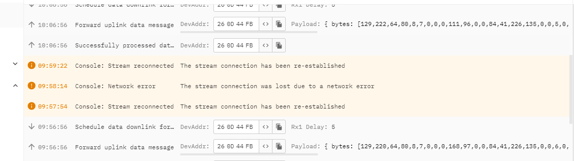

Is it mostly because of the Wi-Fi connection? because sometime there are some message that appear like this
wise1
but is it possible there are something else that can cause this kind of problem?

Jac was using an analogy about turning your device off & back on again as a way of fixing every issue. WiFi has nothing to do with it. The messages you’ve highlighted, details on forum search, are your web browser temporarily losing contact with the backend servers providing the console data.
