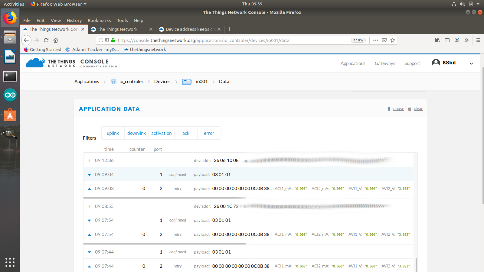

Hi I have a device Authentication OTTA , initially all worked fine I could receive and send data from and to the device. At one stage the sending data to the device failed. When I started to investigate the problem I realized that the Device address keeps changing in the TTN back-end. Why is this happening?
See Attached file, This is the only device currently seen by the Gateway and I restart the device.
I should mention that I still receive updates from the device in my application, which is maked " retry".

The dev address is changing because the device is sending a join request. The problem is not that the dev address is changing but why is the device sending a new join request.
The logs show that the device is sending confirmed packet. If you do that too often you will violate the TTN fair use policy.
I do not know the Draguino I/O controller, you should have a look on the device firmware why is it sending new join requests.
May be the confirmation sent by the network to the device is not handled properly.
Are you using a deep sleep function? May be on wake up, the device has lost its context and then start the association process.

The re-joining only occurs when I reset (re-power) the device. The problem is that I can not sent data to the device, I still receive the shipped, even so its is saying that it is retrying, which it actually dose not .
The data changes so its not the same packet, I know this because the data changes. I have a voltage I’m measuring and the value changes. This device has 2 relays of which I can alter the stage but the data is not arriving on my device. This used to work and it stopped. I will check my device and re register it, maybe this helps.

Thank you for the replies, yes this is setup as class A and the message is sent via a payload from the device interface on the TTN console. In the beginning al of this worked fine and the message arrived on the end-device and I was able to change the state of relays on the device. It stopped working for no obvious reason, however I also having some trouble now communicating with the device via the TTL (USB Com adapter). I have logged a case with the vendor. I noticed in the documentation it raises this issue but the recommended solution do not work for me. LT-33222-L
It is working for me now, I’m using the AU 915 firmware. I some how managed to corrupt my config and needed to reset to factory default. This was not that simple as I could not get any response from my terminal program. It was not responding after a few seconds of running. The solution was to immediately after a button reset to enter the password and then enter AT+FDR this will factory default the unit and keep the all user keys. Here is my config obviously it is for a different frequency but the other settings should be similar.AT CFG OUTPUT X.txt (775 Bytes) Let me know how you going with it!
