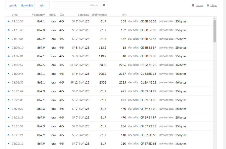

This is what the Lorawan gateway is showing:
Screen Shot 2020-02-11 at 6.08.26 PM

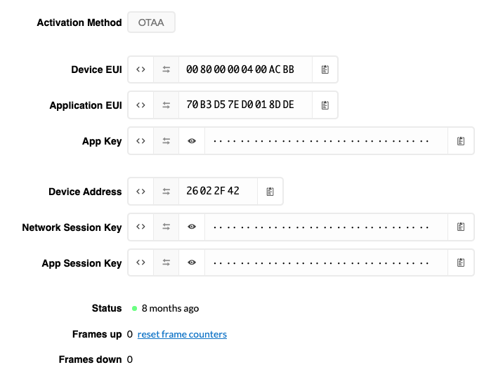

And this what thethingsnetwork is showing on the device overview:
Screen Shot 2020-02-11 at 6.05.50 PM
Does that help answer your question? Sorry, I’m new at all this…

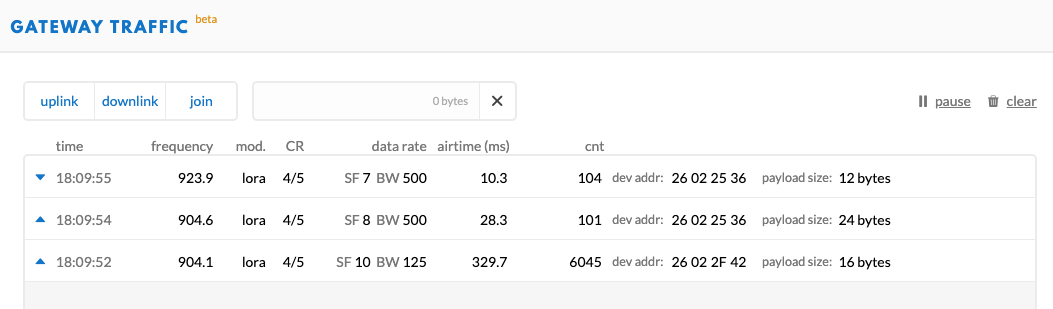

And this is what the gateway is seeing on thethingsnetwork
Screen Shot 2020-02-11 at 6.10.10 PM
The third one is the device in question

The counters are totally out of sync. You will probably need to restart the device to get it back in working order.
Then monitor if it keeps sending data to the application when the counter reaches 64k. I suspect it will not (device on TTN is probably set to 16 bit counters when the node is using 32 bits).
BTW, keep in mind TTN fair access policy allows for 30 seconds airtime for a node per day. You seem to be sending 100 packets in < 2 hours which will result in a lot more airtime.

Not for the 7, for some devices I don’t see any traffic (join or uplink), for the devices appearing in the console their DevAddr are not prefixed with 0x26 or 0x27. See below the trafic.
gateway-traffic

If you are sure your’re seeing data from your devices (and not some other devices in your neighbourhood), then apparently they (re-)joined to the other network. If two networks know the same device, then both might receive the Join Request and might create a Join Accept, in which case it will be a roulette game as to which Join Accept is handled by the device, if any. So, make sure they’re no longer registered with the other network (at least not with the very same values for DevEUI, AppKey and AppEUI).

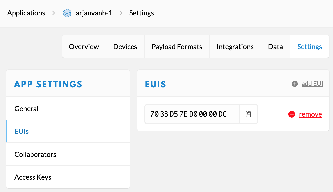

Indeed, you will need the DevEUI and AppKey (in the device’s settings) and the AppEUI (in the application’s settings; in V2 make sure to select the right AppEUI in the device’s settings, in V3 you will also be able to set this in the device directly). If the devices already have those assigned/programmed, then you can also copy these existing values from the device into TTN. For the AppEUI you can add one or more AppEUIs to an application, using either TTN Console or the command line ttnctl.

In TTN Console just go into Settings, and then EUIs, and click “add EUI”.

But you’re right, it seems ttnctl might not support that? I don’t have it installed on the machine I’m using right now; maybe its help shows more options?
The source code does not seem to implement some applications set command either. But for devices set it seems that the --app-eui flag changes the device’s AppEUI rather than selecting some application with that AppEUI. I don’t know if that AppEUI needs to be known to some application already then… In the Application Manager API, the AppEUI might also be part of SetDevice rather than SetApplication.
I’m quite sure that TTN Console uses some of the public APIs as well…
