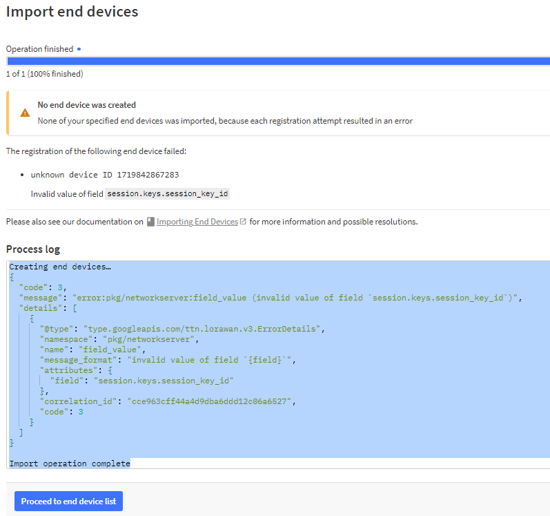

Good day. I have a similar problem. I want to upload devices using a CSV file to use ABP mode.

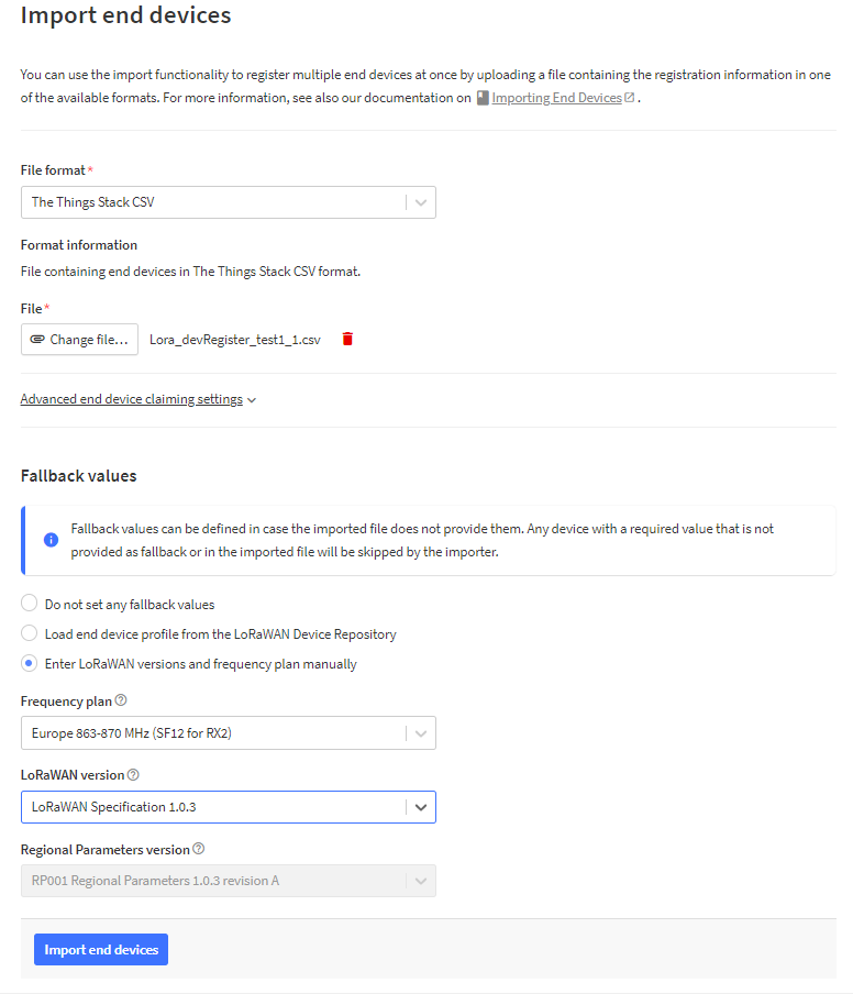

I use the following data and error. I specify the frequency plan manually. Any help will be highly appreciated.
id;dev_eui;join_eui;name;dev_addr;app_s_key;f_nwk_s_int_key;last_f_cnt_up;last_n_f_cnt_down;last_a_f_cnt_down;app_key
tv-1194414082-540488273;526973696E674846;526973696E674846;TV_40;5260D5A2;2B7E151628AED2A6ABF7158809CF4F3F;FF7E151628AED2A6ABF7158809CF4F88;0;0;0;2B7E151628AED2A6ABF7158809CF499F
ERROR:
Converting end device templates…
“end_device”: {
“ids”: {
“device_id”: “tv-1194414082-540488273”,
“dev_eui”: “526973696E674846”,
“join_eui”: “526973696E674846”
“name”: “TV_40”,
“supports_join”: true,
“root_keys”: {
“app_key”: {
“key”: “2B7E151628AED2A6ABF7158809CF499F”
“session”: {
“dev_addr”: “5260D5A2”,
“keys”: {
“session_key_id”: “AZBun3Mkd9lPTrxAKiRCnQ==”,
“f_nwk_s_int_key”: {
“key”: “FF7E151628AED2A6ABF7158809CF4F88”
“app_s_key”: {
“key”: “2B7E151628AED2A6ABF7158809CF4F3F”
“field_mask”: {
“paths”: [
“ids.device_id”,
“ids.dev_eui”,
“ids.join_eui”,
“name”,
“session.dev_addr”,
“session.keys.app_s_key.key”,
“session.keys.f_nwk_s_int_key.key”,
“session.last_f_cnt_up”,
“session.last_n_f_cnt_down”,
“session.last_a_f_cnt_down”,
“root_keys.app_key.key”,
“supports_join”
Creating end devices…
“code”: 3,
“message”: “error:pkg/networkserver:field_value (invalid value of field session.keys.session_key_id)”,
“details”: [
“namespace”: “pkg/networkserver”,
“name”: “field_value”,
“message_format”: “invalid value of field {field}”,
“attributes”: {
“field”: “session.keys.session_key_id”
“correlation_id”: “cce963cff44a4d9dba6ddd12c06a6527”,
“code”: 3
Import operation complete

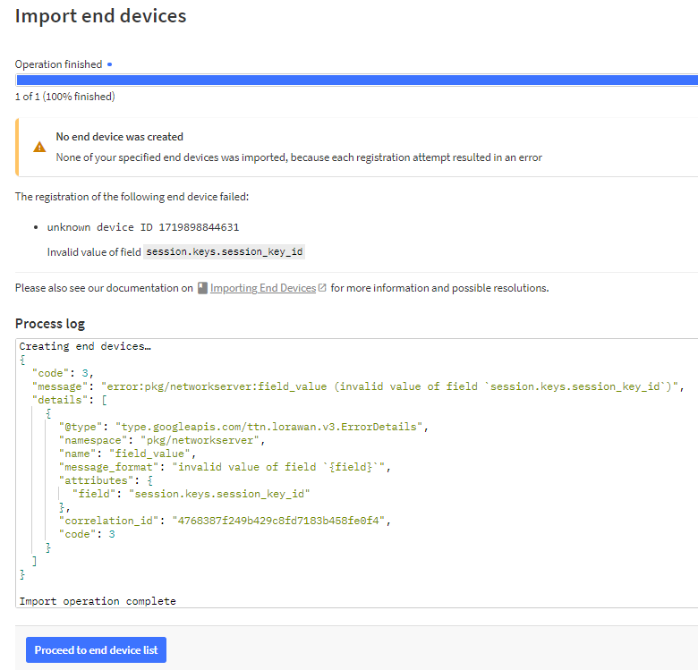

"end_device": {
"ids": {
"device_id": "tv-1194414082-540488273",
"dev_eui": "526973696E674846",
"join_eui": "526973696E674846"
"name": "TV_40",
"supports_join": true,
"root_keys": {
"app_key": {
"key": "2B7E151628AED2A6ABF7158809CF499F"
"session": {
"dev_addr": "5260D5A2",
"keys": {
"session_key_id": "AZBx9Z7s8C7mBcmEIgAUhA==",
"f_nwk_s_int_key": {
"key": "FF7E151628AED2A6ABF7158809CF4F88"
"app_s_key": {
"key": "2B7E151628AED2A6ABF7158809CF4F3F"
"field_mask": {
"paths": [
"ids.device_id",
"ids.dev_eui",
"ids.join_eui",
"name",
"session.dev_addr",
"session.keys.app_s_key.key",
"session.keys.f_nwk_s_int_key.key",
"session.last_f_cnt_up",
"session.last_n_f_cnt_down",
"session.last_a_f_cnt_down",
"root_keys.app_key.key",
"supports_join"
"code": 3,
"message": "error:pkg/networkserver:field_value (invalid value of field `session.keys.session_key_id`)",
"details": [
"namespace": "pkg/networkserver",
"name": "field_value",
"message_format": "invalid value of field `{field}`",
"attributes": {
"field": "session.keys.session_key_id"
"correlation_id": "4768387f249b429c8fd7183b458fe0f4",
"code": 3
Clearly something going on here trying your data (EUI’s changed to prevent clashes) I get the same result and the error message doesn’t really make sense given that it is produced by the stack, it’s not part of the import csv.
As you need 50 setup which is outside the normal scope of TTN / Sandbox, perhaps you should get a support contract with TTI, @rish1 will provide you with the details.

Hi, I managed to import APB devices using JSON. I include the JSON that worked:
"ids": {
"device_id": "grove-4",
"dev_eui": "2CF7F1204200A644",
"name": "My grove4",
"description": "json for APB",
"lorawan_version": "MAC_V1_0_3",
"lorawan_phy_version": "PHY_V1_0_3_REV_A",
"frequency_plan_id": "EU_863_870_TTN",
"supports_join": false,
"root_keys": {
"app_key": {
"key": "2B7E151628AED2A6ABF7158809CF4F3C"
"session": {
"keys": {
"f_nwk_s_int_key":{
"key": "AA02030405060FF801020304050607CC"
"app_s_key":{
"key": "01FF030405060708010203040506CCAA"
"dev_addr":"FF0203BB",
"last_f_cnt_up":1,
"last_n_f_cnt_down":1,
"last_a_f_cnt_down":1
