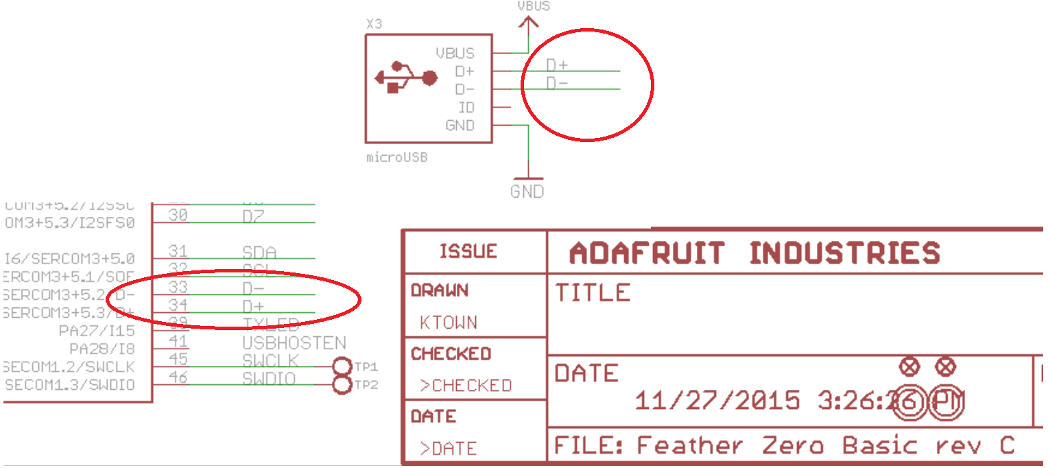

In reality, the Feather M0 device mentioned by topic starter has badly designed USB connection circuit:
Full schematics

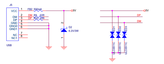

Safe design of this circuit should look similar to this one:
That has little likelihood of being an issue, especially as this is only a full-speed device.
Rather problems are typically the USB code in the chip not being actually running, as already explained. Also mentioned were strategies to work around the USB entirely.
