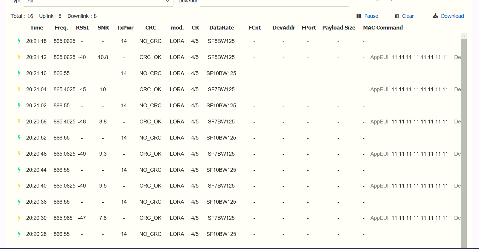

But, while going through packet logger inside the gateway I can see below-mentioned join request payload
“JoinRequest”: {
“AppEUI”: "11 11 11 11 11 11 11 11 ",
“DevEUI”: "50 6F 98 00 00 00 10 00 ",
“DevNonce”: “71BD”

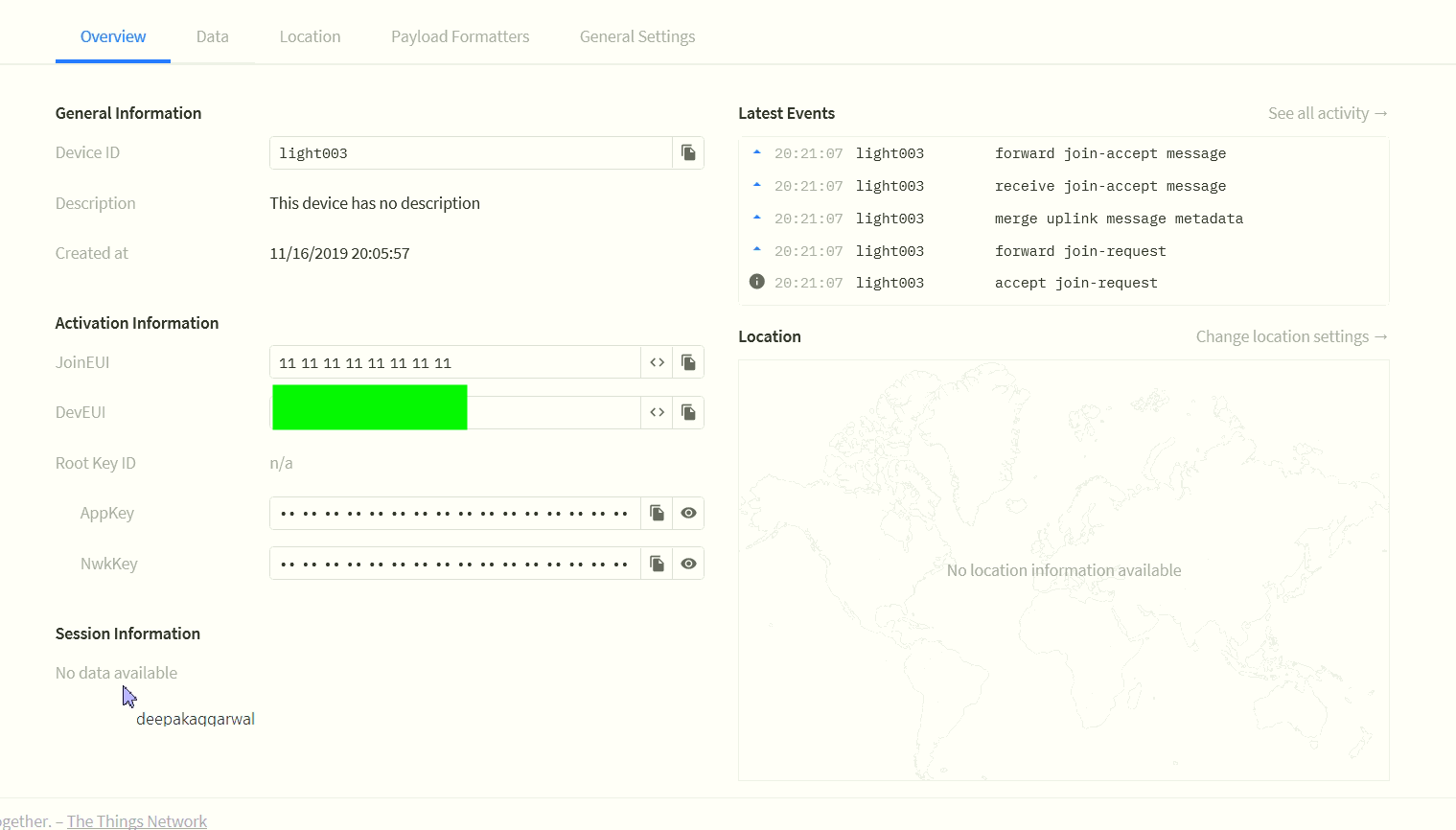

I am using lorastack version 3 running on the private instance. The above problem got solved after I selected Reset Join Nonces
Though I am not getting any session information after the join accept request

I also noticed one peculiar thing. My device does not stop sending join request messages until it receives join accept on the same frequency.
50%20PM
To clarify, you are using the TTN server software stack, but in a private instance rather than using TTN itself. (You are also using a newer version than is currently running the TTN network, though it is unclear if that, or your desire for class C, etc is actually yet relevant)
Your issue however seems to be a fairly simple one - probably as a result of restarting your node, you have sent an invalid dev nonce.
